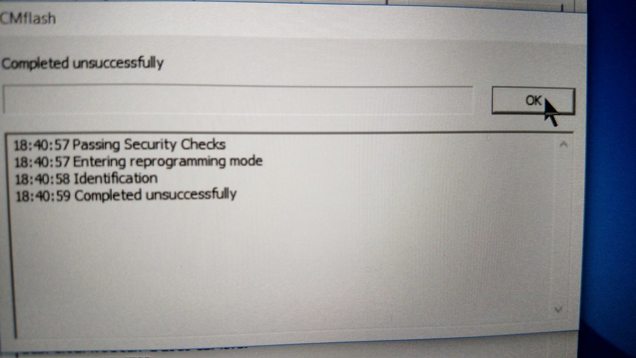

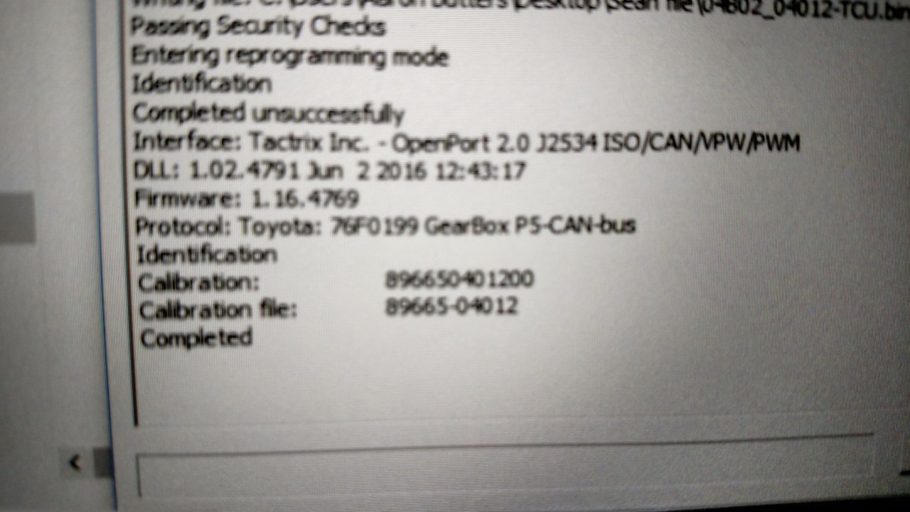

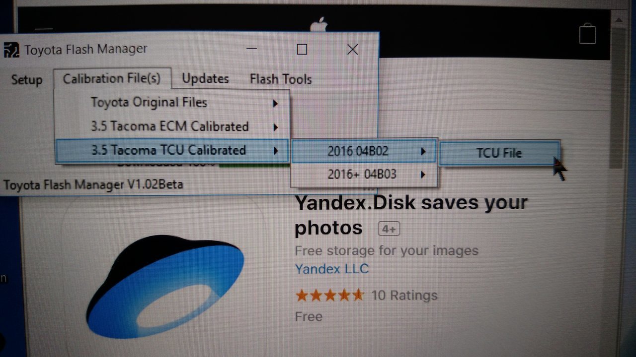

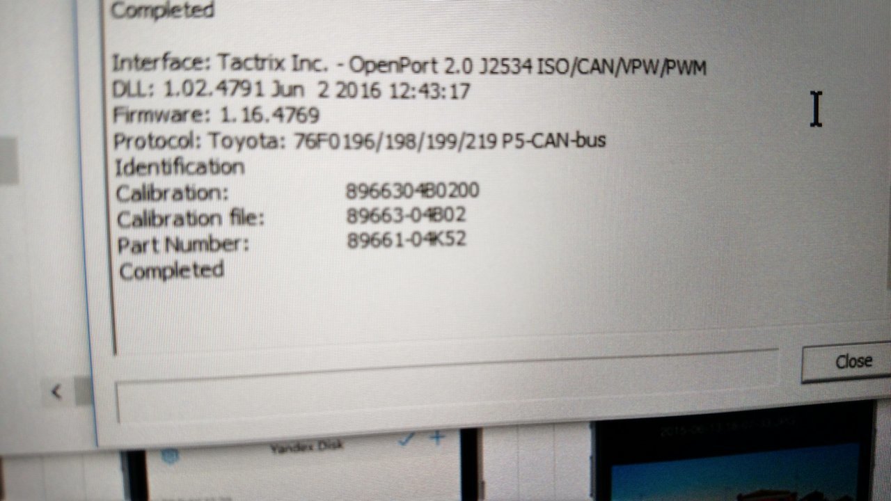

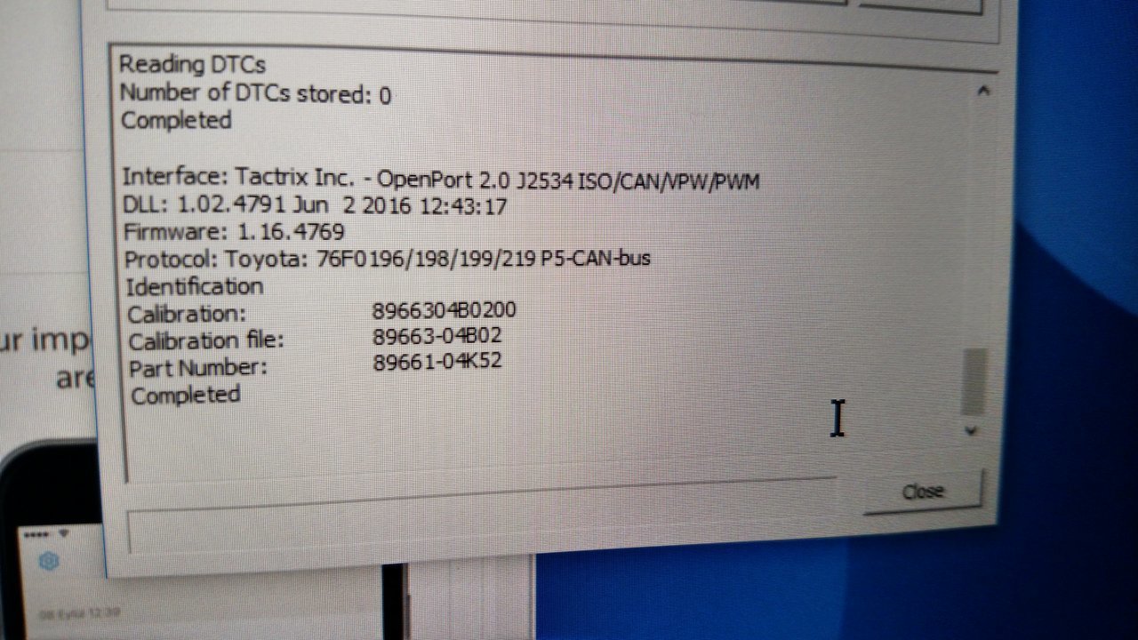

    SoCal
    17 Pro
    Bueller?

    9 out of 10 times when someone gets unsuccessful they do not have their truck completely on, they just put it in accessory mode.
