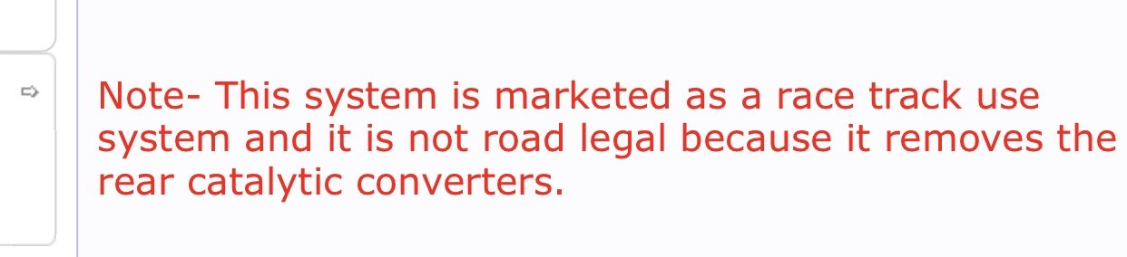

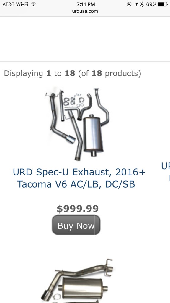

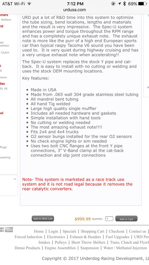

    It's illegal. Don't show up with illegal shit.

    Rear cats are not monitored / have O2 sensors. So no CEL or not ready codes. Removing them wont do anything but make noise. Even in CA, unless they physically get under the truck and go "where are the two rear cats from the factory system?"
