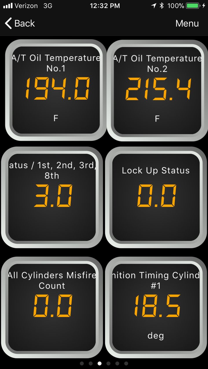

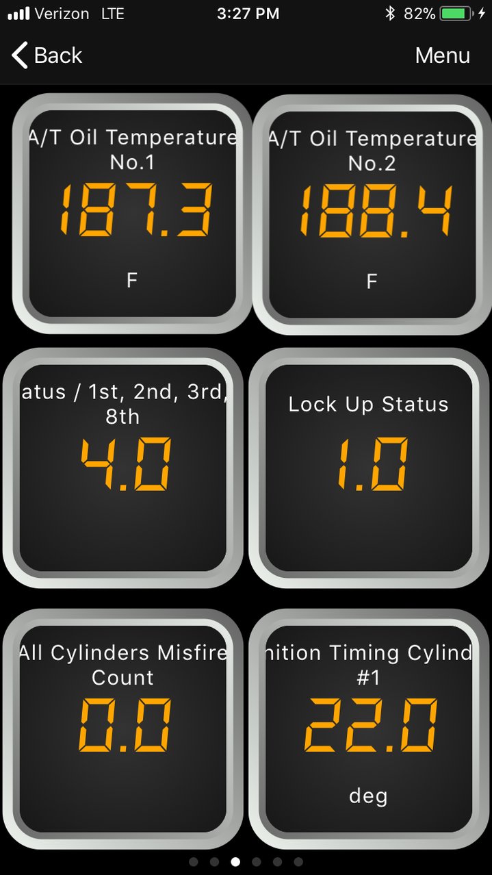

  8. Mar 3, 2018 at 9:14 PM
    PB FAB
    PB FAB Well-Known Member
    Apr 11, 2017
    #215942
    805
    2017 SR DCSB 4x4 v6
    Hey @OVTune
    Matt I just drove up to Big Bear for the night and I have a question. Is it possible to make 3rd gear lock the torque converter in S mode? When I was climbing the hill I would put it in 3rd to hold rpm’s and the converter temps would rise, then I would put it into forth and the temps would drop by 20 plus degrees once the converter locked.
    3rd gear temps
    4th gear locked

    OVTuned w/ 5.29s 2” lift on Dobinson’s MRR paired with ICON RXT leaf packs. SCS RAY 10s Toyo Open Country AT III 285/70R17
    What PIDs did you use for the lock, misfire, and gear selection status? I have the OBD FusionToyota pack, but can’t seem to located those. Thanks.

  20. Mar 4, 2018 at 6:16 AM
    PB FAB
    Apr 11, 2017
    #215942
    805
    2017 SR DCSB 4x4 v6
    These are in the transmission pid section.
    Status of the gear status
    Lock up status
    In the engine section you will find all the different misfire pids.
