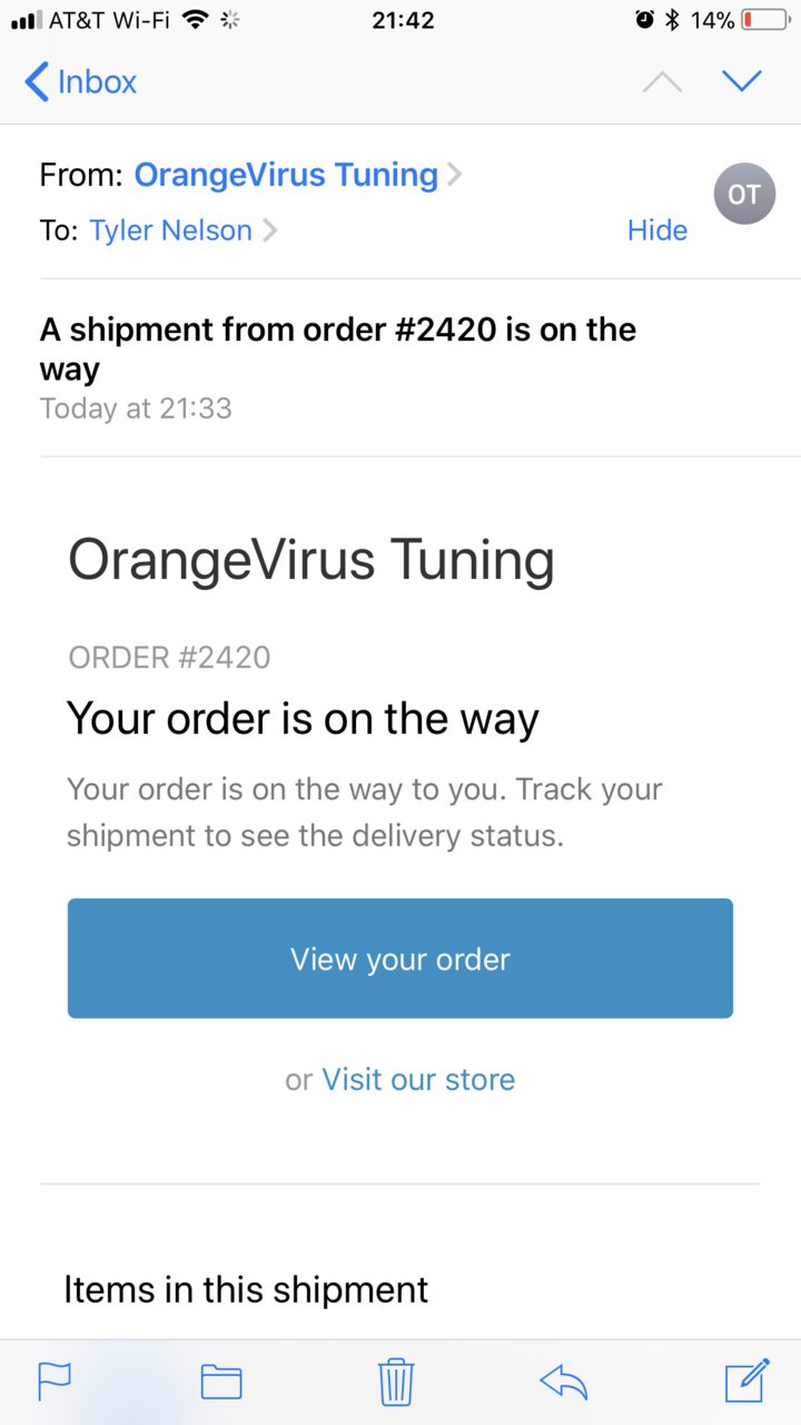

    Yes! It happened finally. Now we wait a few more days!
