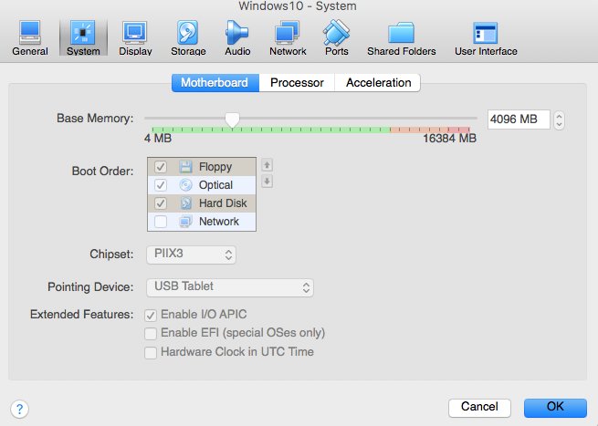

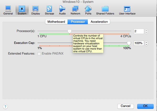

    For anyone wondering if you can use Virtualbox on a mac to do this...yes, easily and it's free. But it's going to be really laggy if you don't give the VM at least 4GB of RAM and 2 processor cores to work with. I think it defaults to 2GB and 1 core which is gonna suck.
    Gotta understand you're running a whole second virtual machine on top of your mac so you need enough RAM to support both. I have 16GB in mine so giving 4 to the VM isn't a big deal but if you only have 4 to start with you're gonna have problems obviously.
    This doesn't matter with Bootcamp because you're only ever running Windows or OSX in that scenario, not both.

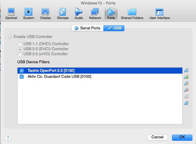

    Also you have to add the dongle and OBDII USB devices in the Ports/USB settings (green + icon on this page) for it to pick them up.
