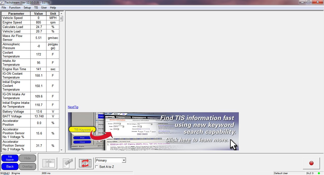

    Ok I got everything set up and was able to connect to my truck through the TACTRIX interface. Finally figured out how to select PIDs and create my own data list, and ultimately monitor same. It looks pretty easy to capture/save logs, but I'm going to enlist a co-pilot for that - I want to capture these stutters as accurately as possible.
    Hmm.. only thing I didn't get working was the graphs showing real time data - only had the list on the left side of the screen with values changing.
    @OVTune , any suggestions as far as PIDs go in techstream?
    So far I've got:
    Accel pos'n
    Throttle pos'n
    All cylinder missfire count
    Intake VVT target angle bank 1
    Exhaust VVT target angle bank 1
    Ignition timing cyl 1
    AFR
    MAF
    KC learned value
    ACIS duty cycle (that's the intake flapper thing in the air tank)

  10. Mar 11, 2018 at 3:22 PM
    nxcess
    nxcess Well-Known Member
    Oct 16, 2014
    #140482
    351
    '17 Tacoma MT 4x4
    OVTuned
    Are you at this screen? Double click on any of the parameters and it'll show live graph.

  12. Mar 11, 2018 at 3:53 PM
    MOC221_
    MOC221_ 3 pedal metal
    Feb 20, 2016
    #178858
    7,850
    Frank
    2019 DCSB Sport M/T Barcelona Red
    vF Tuned; ADM; Core SS
    Yep, that exact screen..ah ok, thanks!
    Damn touch screen stylus thingamabob on the flashing laptop makes me :annoyed:
    Yeah I know I could hook up a mouse, but that's not too convenient on the road lol.
    K gonna try and get some logs together tomorrow.

  14. Mar 11, 2018 at 4:04 PM
    BigWhiteTRD
    BigWhiteTRD Official thread killer (only crickets remain)
    May 24, 2017
    #219848
    1,673
    Ted
    Treasure/Space Coast Florida
    2017 AC TRD OR Auto 4wd, 2012 AC SR5 4.0 MT 4wd
    @MOC221_ , had same results as you, I never got real time plots to work, but didn't try hard. @nxcess , guess I never double clicked a single one from that screen.
    What I did while recording data was to save the files while driving (by pulling off road) to some kind of native Techstream format. Seemed like a 5min max time per file. After the drive I found I could load them into Techstream then use export function to put out csv or something similar. (Then import into excel, just straight opening them in excel made excel not recognize the separator characters for columns)
    I strongly suggest the following if you really want to be able to narrow in on the issue and it is elusive. Record a video while you do all this. It doesnt need to be a good video, as the audio is the most important. Start video, then start recording Techstream. When truck misbehaves, say something on video. From replaying video you will know what time you are looking for to within a second or two. Then go to the Techstream data set to find that area. Makes it much easier to narrow in on it. Just +/- 30 seconds can become daunting and alot more unclear when you have 10hz data.
    bshammer0 and MOC221_[QUOTED] like this.
