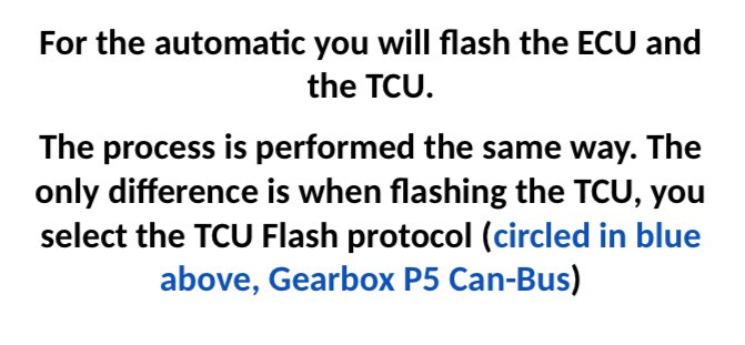

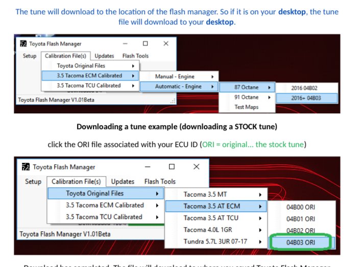

    I just realized that I only FLASHED MY ECU "NOT" TCU. PLEASE ADVISE
    Truck feels awesome on the 91 tune !

    er... flash the TCU?
