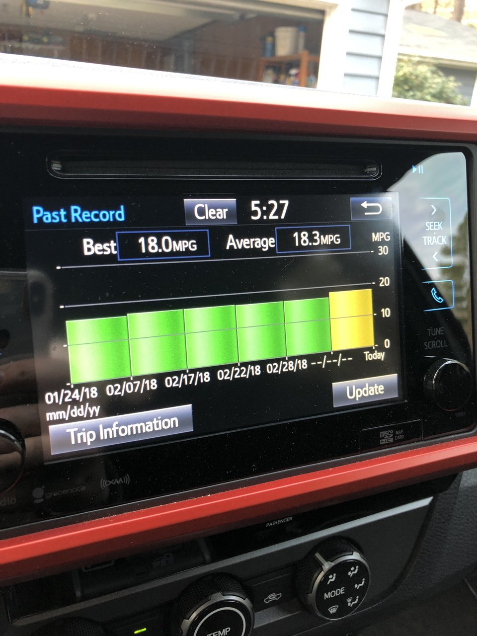

    glassremy
    glassremy Well-Known Member
    Dec 28, 2017
    #239643
    199
    NC
    2017 Silver TRD 4x4 OVTuned
    Ive gone through a little over a half a tank with the 91 tune and I am getting better MPG than ive achieved in the past. I get up to speed a lot faster and less lugging up hills, i think it works out to a better overall efficiency ..instead of slowly creeping up to speed, i use a little power at first to get up to the speed which allows more coasting and carrying speed over oncoming hills. I live in a very hilly area.
    falken wildpeak 265/70-17 and air dam removed. im not sure why there is no date for my last fill up, i always click update when i fill the tankIMG_1392.jpg
    honey and Saeros like this.
