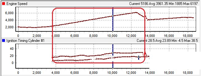

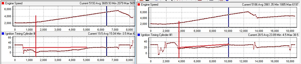

    posted this in the MT thread as this is from some datalogs taken from MT owners
    the difference in ignition on full throttle when comparing 87 octane to 91 octane
    Runs side by side (87 left, 91 octane right)
    ignition combined on single graph bottom
