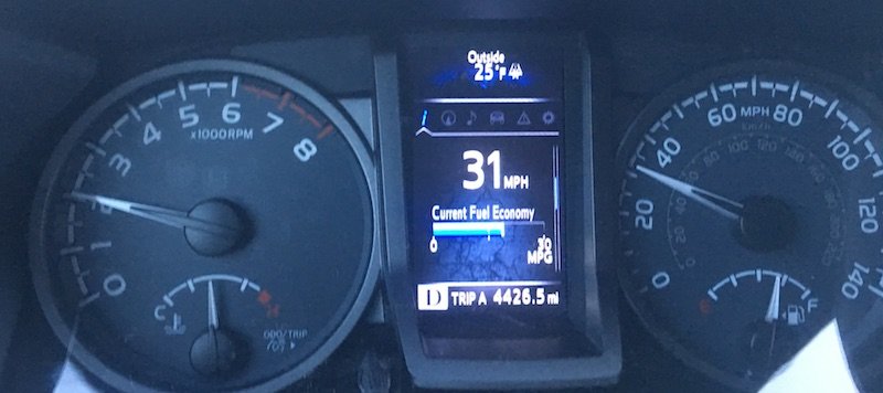

    Are you doing the "go to 35 and then slow down" thing to make it upshift before you set your cruise? I get the maxed out reading for mpg, too, as long as I've convinced the truck to upshift. If it's holding 3rd, the mileage is definitely lower. For the screen shots below, I had a hard time getting it to stay exactly at 30 mph in 3rd gear without using cruise, since with the engine in its power band, it wants to jump with the slightest throttle input. But the mileage bar is pretty close to what it would be at 30. I guess to be scientific, I should have gone out to an empty, flat road, and set cruise at 30 for both images...

    I had some time to kill during a kid sports practice last night, so I did a few test runs on a flat road near the school. I used grandma-style throttle and took the truck from zero to 60, briefly holding speed at 5 mph intervals to check rpms. I didn't log the exact numbers, but 5, 10, 15, 20, 35, 40, 45, 50, 55, and 60 all are under 1500 rpm. Some of them are as low as 1100. 25mph is turning maybe 1600 or 1700. 30 mph is 2000 or slightly above. "One of these things is not like the other."
