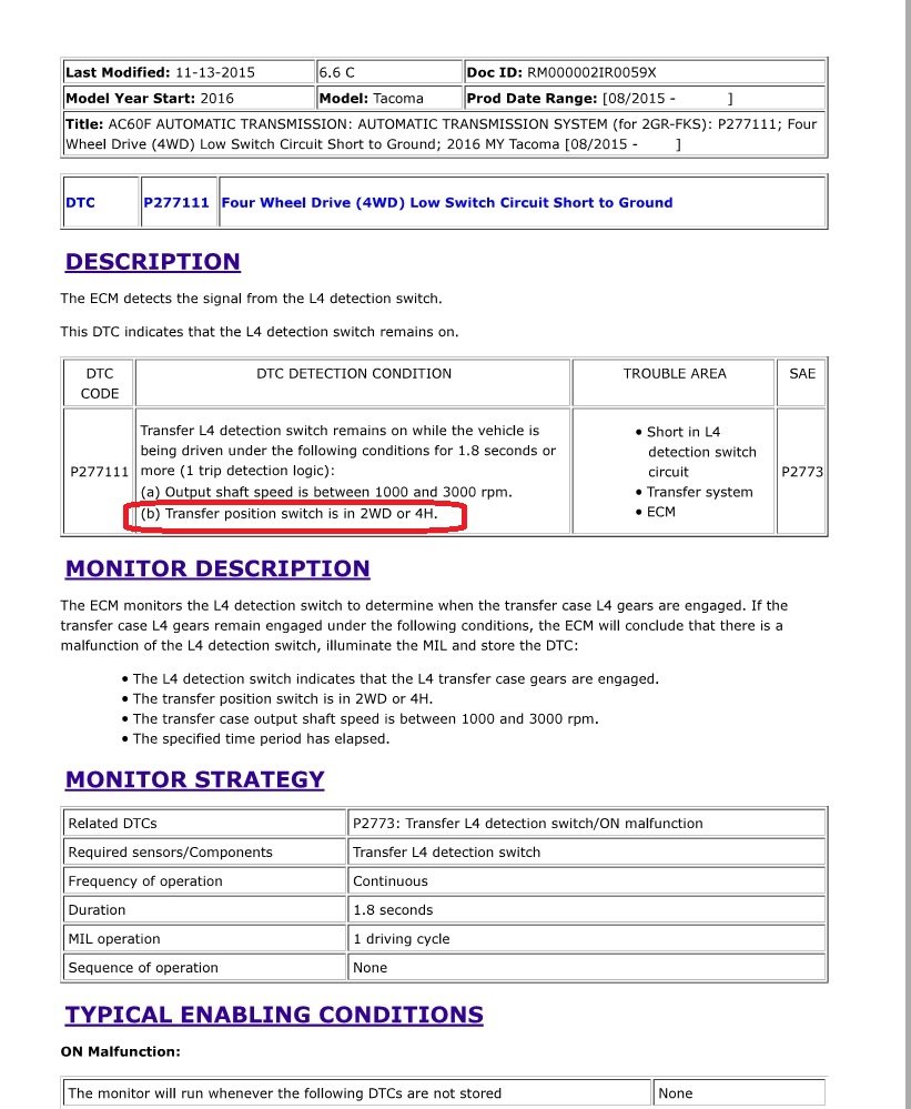

    I'm sure this question was asked in other threads WRT the 3rd Gen, and there were some diagrams posted by (splitbolt?) showing more system complexity (ie CAN BUS signals). I've dug around a bit in the service manual, and it seems there are at least three assemblies involved in the 4WD Hi/Low and diff lock logic/monitoring - the ECM, 4WD ECU, and skid control ECU. If the 2nd gen mod was simply faking out the 4low engaged signal coming from the transfer case, we have a problem. The ECM "knows" that you've not switched to 4WD Low and will set a code:
    I know, it's off topic... but the question was asked and I need to keep my mind occupied waiting for M/T feedback lol!
