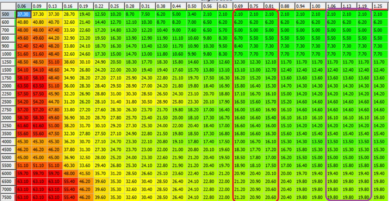

  9. Jul 6, 2017 at 8:24 PM
    #1349
    OVTune
    OVTune [OP] Well-Known Member
    Mar 27, 2017
    #214557
    8,112
    OVTune
    changing the DFCO controls so fuel doesn't come back on until closer to idle would make a difference.
    Yes the engine operates in atkinson at low to moderate load, low RPM.
    We have control / understanding of the Valve control, maps / tables / limits, etc. But the valve advance control is not very complex. There is no evidence it is mode dependent. Rather it is static based on 2 maps and advance limits.
    We can disable and or modify any and all engine characteristics / atkinson via the camshaft control tables. I've done this quite a bit with some Mazda Race cars that use the same style calibration on the Skyactiv. You lose MPG as a consequence.
    Elevation is already factored into a stock tune, our tune only accents the stock controls. Elevation isn't as important as load. Engine load is calculated by airflow. More load = more air = targets different area of XXX table with load as an axis. Less air = less load = lower load section of that axis.
    here is a picture to show you what I mean, in a simple way.
    This is an ignition map. Lets say as an example, at full throttle at sea level, you hit around 1.05-1.10 load. Your ignition target would be somewhere in the area circled in PURPLE.
    Load is calculated by measured air.
    Lets say you floor it at high elevation. Less air = less load overall.
    Now you're only getting around 0.7 - 0.72 load. Your target ignition is now the area in red.
    More ignition automatically, not much, but it's more.
    anyways that's all for tonight, thanks everyone
