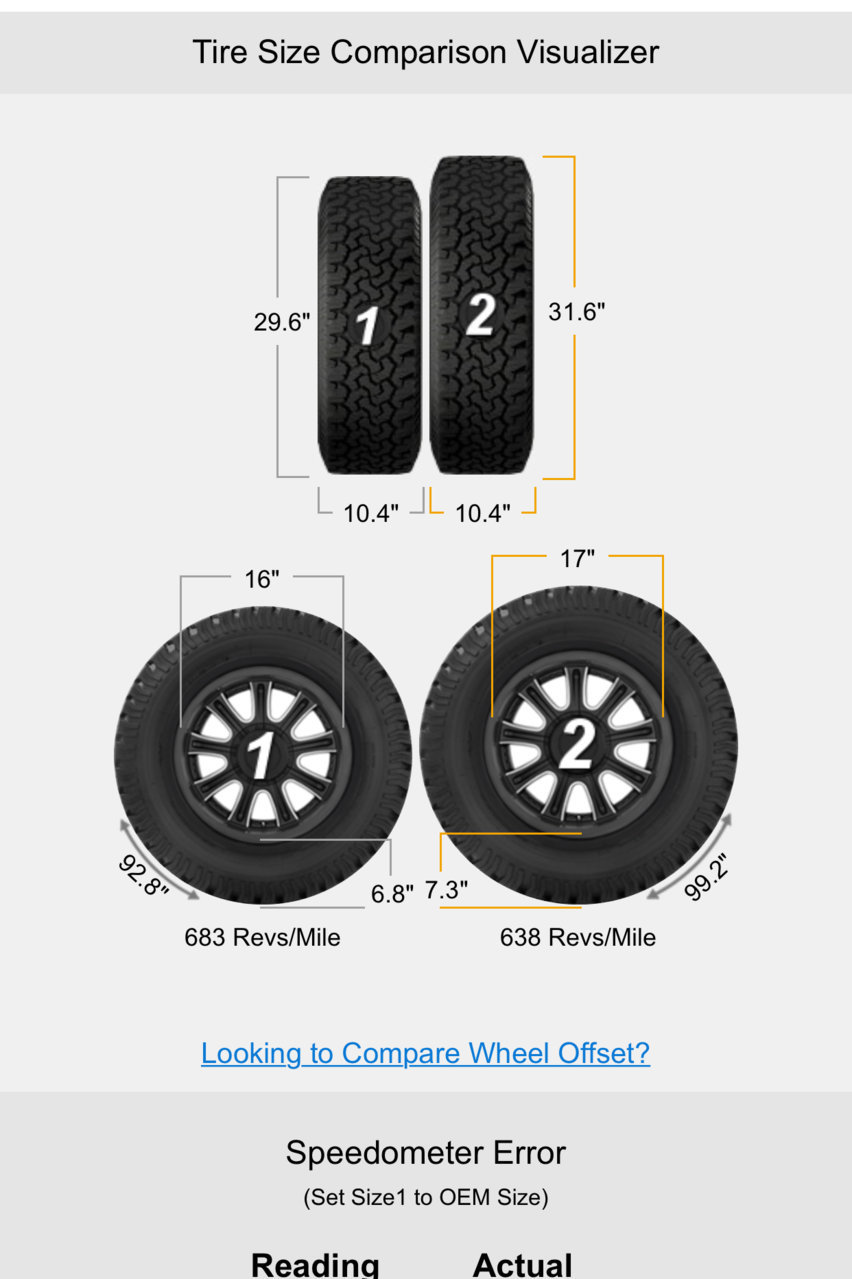

    Alright, serious question here. Learn me up please because apparently I've been learned up wrong. How does a 1" difference in wheel size result in same diameter with the 65 vs 70?

    Yeah I get that. But how does that correlate to equal diameter with different sized wheels? A difference of 5....what, percent?... seems so miniscule
    Does that really make up that large of a difference?

    This is easiest way to understand what’s going on. Punch in some sizes and it’ll show you all the dimensions

    The second number in the tire size is the aspect ratio, and tells you the sidewall height as a percentage of the tread width. So, you multiply that by the tread width to get the sidewall height in mm (on one side of the tire). Multiply that by two and divide that by 25.4mm to get the total sidewall in inches. Add the wheel diameter to get the total diameter.
    265/70 R16 = (265 x .70 x 2)/25.4 + 16 = 30.61"
    265/70 R17 = (265 x .70 x 2)/25.4 + 17 = 31.61"
    So as you can see, the only difference here is the 1" difference in wheel diameter.
