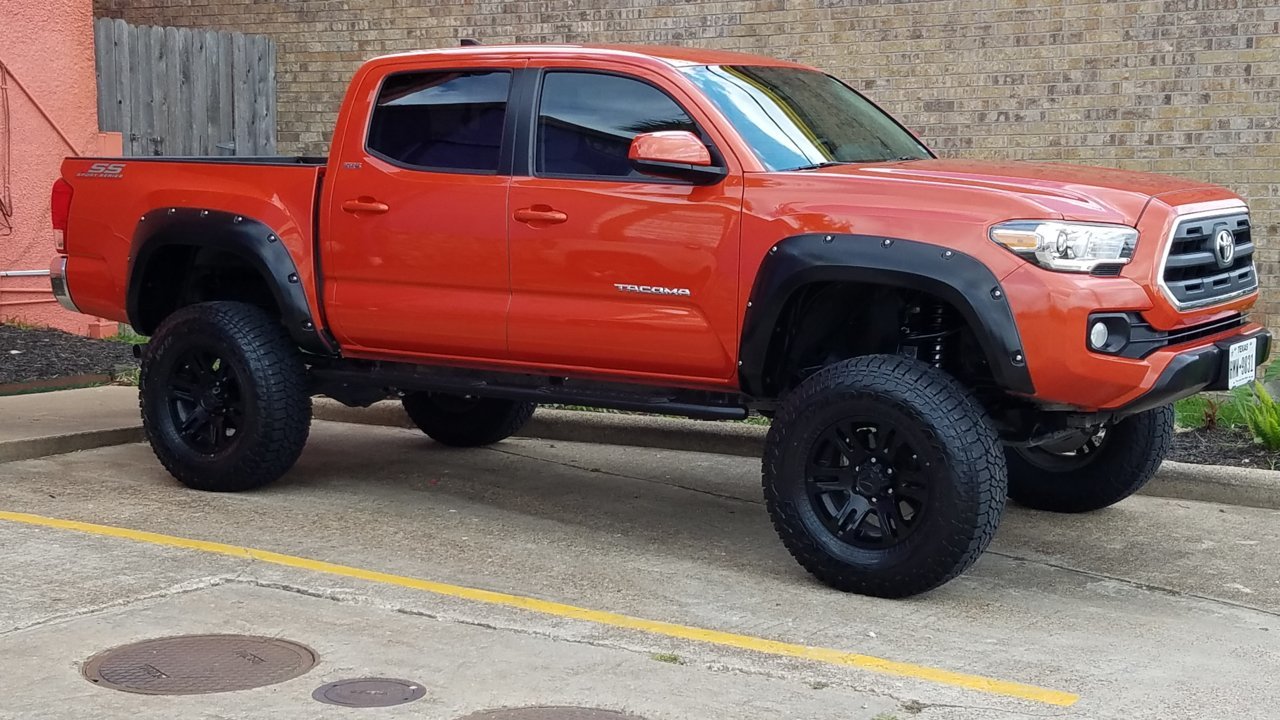

    I know exactly what you're talking about and I figured out what it was, by accident. Dealer kept saying normal, but I told him my tranny or driveshaft was going to be trash before to long if that was true. What I found out was that there is too much play at the driveshaft spline/ yoke connection. So every time I came to a stop the driveshaft would slip towards the tranny and cause that damn feeling like someone was hitting at low speed from behind. But, when I went up 6.5" of lift I had to add a spacer. 4Crawler did the calculation for me but I also knew what others with my same lift had used. Added 1.25" and now all of a sudden that bump is gone. ??
