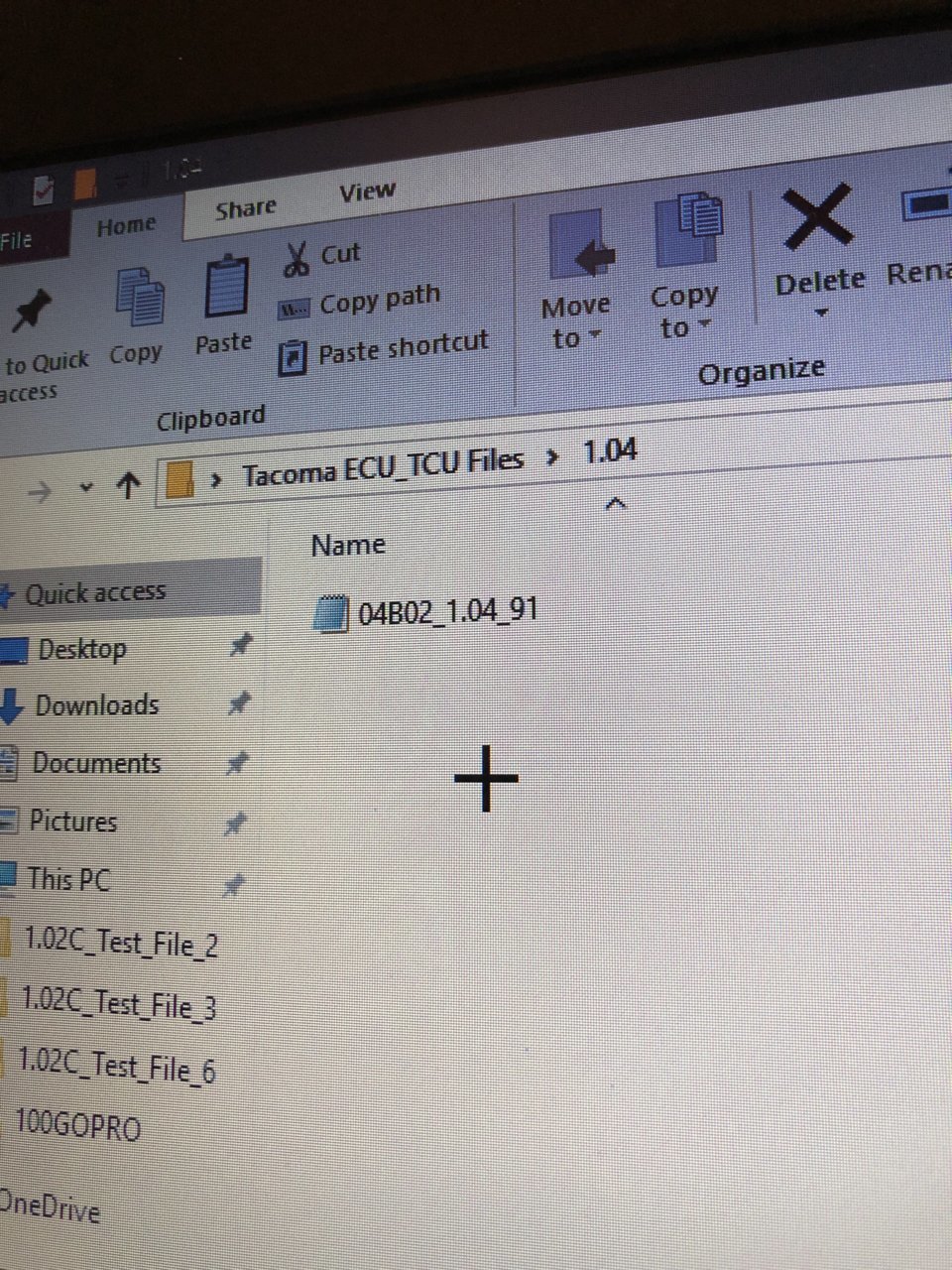

    Is the file name still 04B03? Is there any indication it's 1.04 under flash manager?

    Nope. It’s just there.
    But when you download it, the .hex file is named correctly

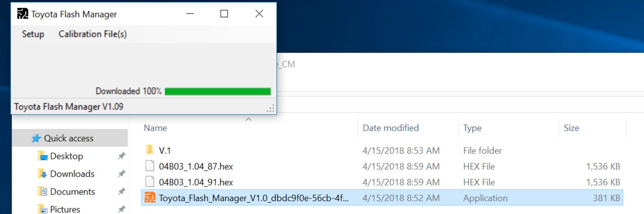

    Hey AT 1.04 tuned guys,
    I opened the new PCM flash, but it still say V.1 on the flash name.
    I downloaded from it the new ECM files, both 87 and 91, but they are .hex files.
    Can someone just verify this correct?
    V.1 Folder is the 1.0 tune

    It’s fine. Just when you go to flash, you’ll have to choose the file type as “anything” or something.

    That is correct...I just flashed the 91 hex file.

    Sorry, this post is a tad bit misleading, your # extension 4B03 or 4B02 is all based on what your ECU checked at when you configured your truck. In this case dYl0n's is 4B02. Just thought I would clear this up in case someone is selecting what they see.

    The 04B02 or 04B03 are the ecu versions from Toyota.

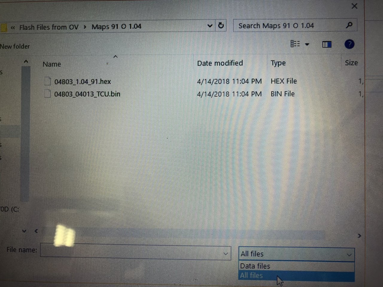

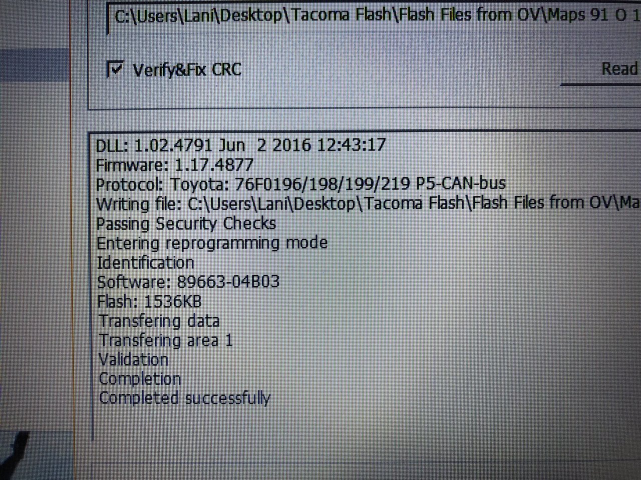

    Here is a screenshot. Dropdown to "all files", this will show the hex file. choose this hex file to flash.
    Hope this helps.

    Correct.
    04b02, 04, etc., is what version toyota put on it.
    If I went to the dealer and got an update, it’s be whatever is newest.
