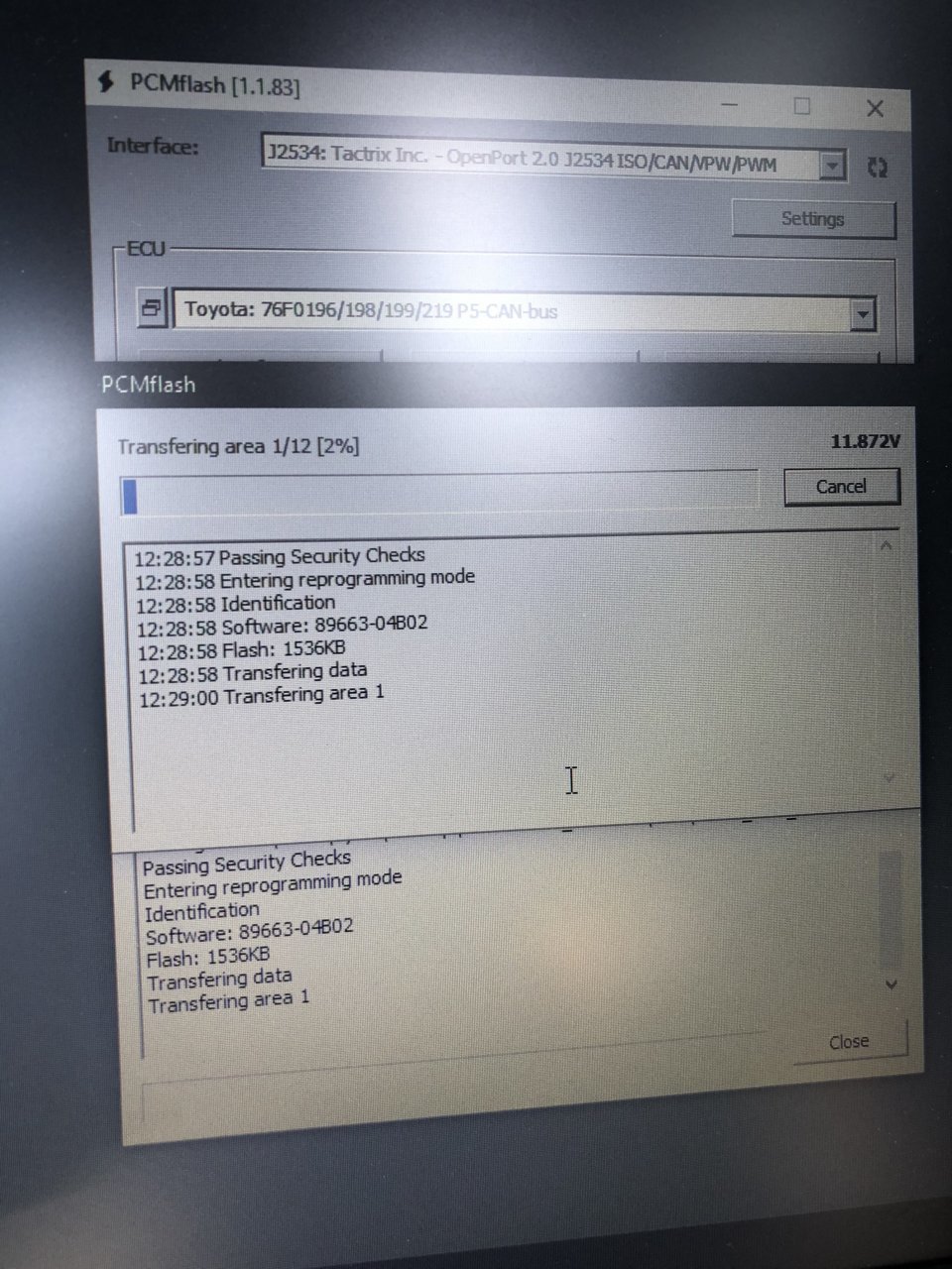

    Just downloaded 1.04 and flashed. Truck won’t start. Tries to start and then throws a “brake overide” error. Had 1.03 and was upgrading to 1.04. Anyone experience this and have any recommmendations for recovery? PCM flash won’t even get through the identifiacation step at this point.
  5. Apr 15, 2018 at 10:21 AM
    dubstyle7
    dubstyle7 Well-Known Member
    Apr 20, 2017
    #216791
    208
    Nic
    Dana Point, CA
    2016 Super White Tacoma TRD Sport 4X4 DCSB
    I'd try flashing again if you can. You shouldn't need to identify first, so if it doesn't, flash anyway.
  6. Apr 15, 2018 at 10:23 AM
    yota602
    yota602 Member
    Feb 2, 2018
    #243211
    24
    2017 Inferno OR
    Air, exhaust, full armor, King and OME struts, Deaver leafs
    Restarted everything and now stuck in this spot.

    This is important to note. The latest update is 04B03 correct? So if someone had the time then got a flash update from the dealer (not sure why one would do this) then they would need to reflash with the correct 04B.. syntax correct?

    What spot?

    Truck won’t start and PCM flash will not complete Identification or Read DTC.

    Redownloaded PCM Flash and still stuck.

    Reflashing now without the Identification step. Fingers crossed!

    Load the file in pcmflash again (the three dots...) click write, let it flash again
