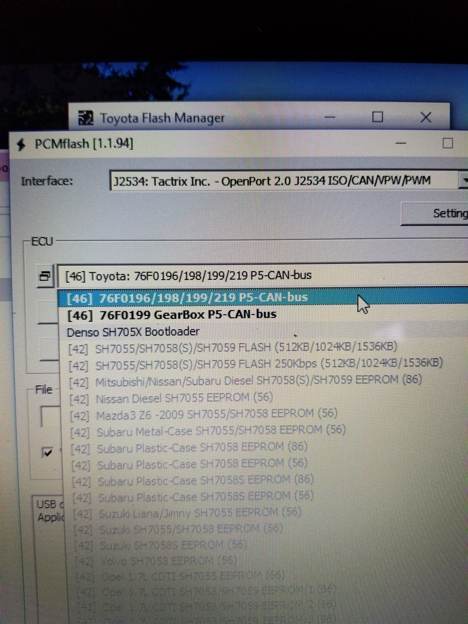

    I left it on the thing highlighted

    So I don't flash anything to the gearbox option. Ever.

    Better yet, tell me how you flash your truck. You flash the ecu to the canbus and the TCU to the gearbox? Or do you flash them both to the canbus? On any of the tunes that were released

    Im confused man.
    There were several tunes released. Some had gearbox tunes, some didn’t.
    1.03 was gearbox and canbus.
    Flash 1.03 ECU file to the can bus
    Then
    Flash 1.03 TCU file to the gearbox
    If you happened to do 1.03 and now you want to do 1.04:
    When you open PCM flash, it’ll be selected to the last thing you did, so probably gearbox.
    1.04 doesn’t have a TCU file, only ECU. So flashing the 1.04 file to the gearbox won’t be good.
    So I’m basically saying, make sure 1.04 goes to the P5CANBUS option, not gearbox.

    I never flashed anything to the gearbox I don't think, that's what I'm trying to say

    If you have never flashed 1.03 tcu file to gearbox, I suggest you do so if you are unsure and never did it previously.
