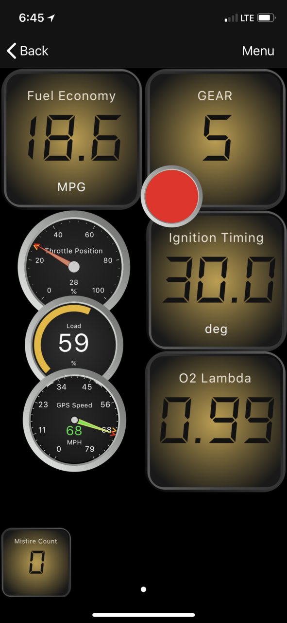

    The truck won’t go into 6th at 38-40. That’s 5th. I’ve been watching with obdfusion.
    The torque converter locking makes it feel like it shifts, but cruising at 39 (the speed I set my CC to on my commute) it’s at about 1100 RPM, locked in 5th.
    If you were in 6th at that speeds, you’d be below 1,000 RPM. Not gonna happen!
    The reason I’m asking about 6th, I was going 55 and noticed it didn’t go to 6th. Then I went up slowly in speed and ended up cruising at 65 (per dash). 5th gear.
