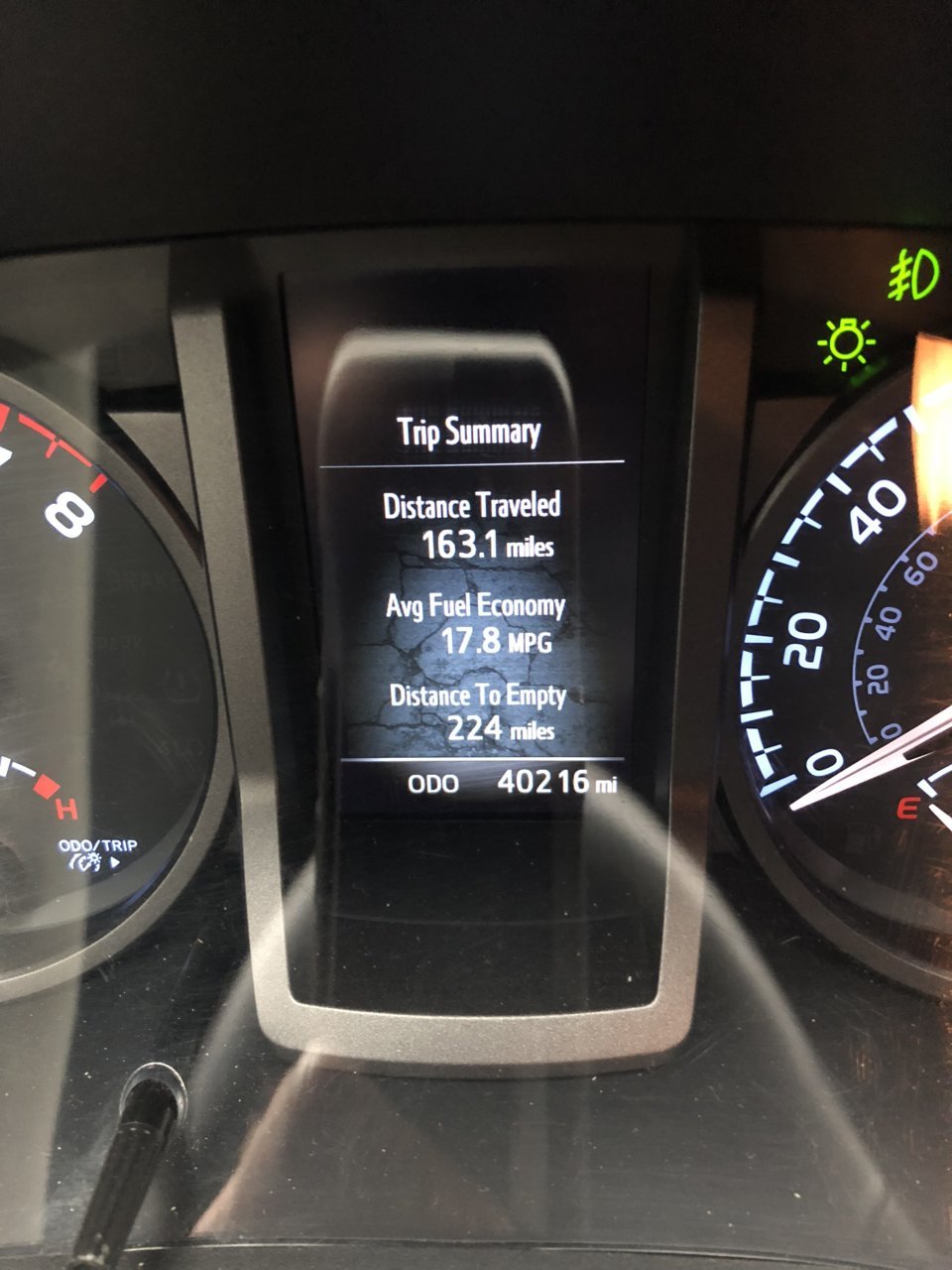

    150 miles in so far. All highway with hills and speed limit above 65 miles an hour. 1.04 is beautiful.
    Throttle input required for acceleration may have increased, but the drivability is significantly improved.
    The power is definitely still there – might have to use a little more skinny pedal.
    My favorite improvement has to be the functionality of cruise control . If you haven’t tried it yet I suggest you do so. It’s super smooth - no searching for gears. My 3 Hour Weekly Drive just got better.
    [ using talk to text]
    Update:
    Just finished the drive. I’m really impressed.
    *18.2mpg driving 75. Was 19.2 until the last 30 miles of steep hills through From Portland ME to Bath ME on 295N.
    • 91 1.04 (on 93 octane)
    • 265/75 R16 Falken Wildpeaks @ 30psi on SCS Ray 10’s
    • Plate bumper
    • Full skid
    • 10,000 lb winch
    • ARE shell
    • 2” lift
