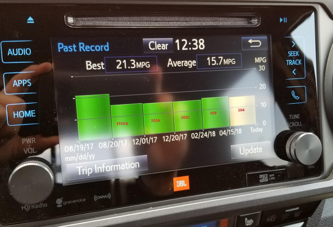

    For those interested, here’s a comparison of my fuel economy based on the tunes I’ve ran. I know some people have noticed increases in mpg but in my experience the mileage has stayed the same. Even if it had gotten worse, the tune would still be worth it just to have a drivable truck. I know my mpg’s look bad, but most of my driving is to work and back which is a short trip and the truck barely gets warmed up. This is also on winter fuel so if the temperature ever increases hopefully my mileage will also.

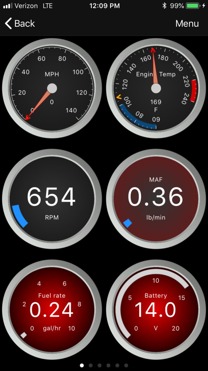

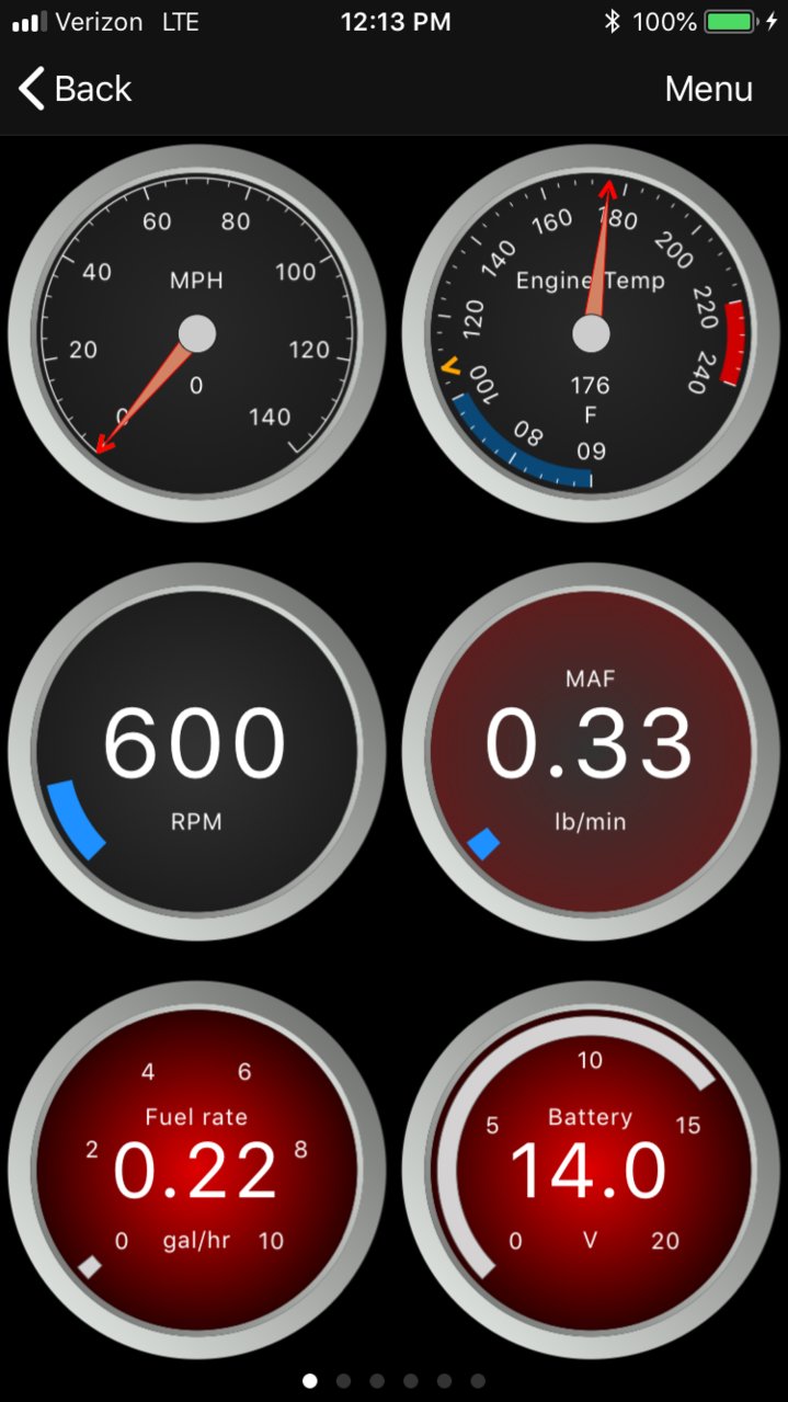

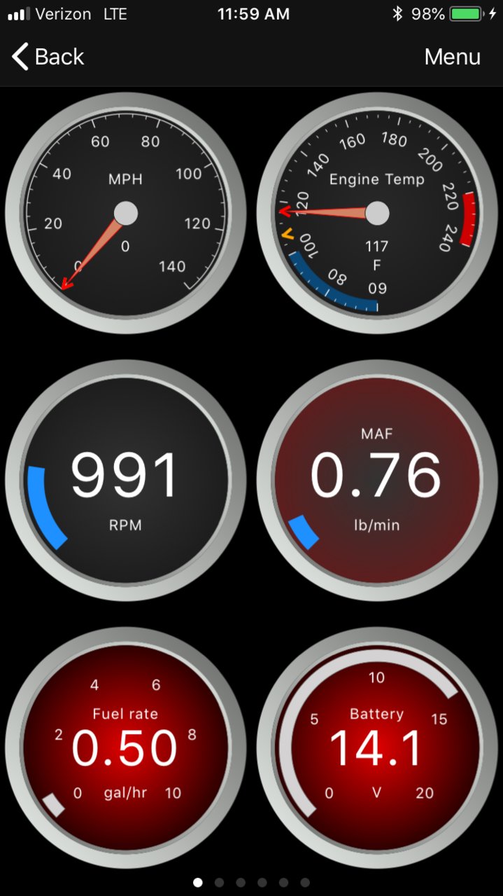

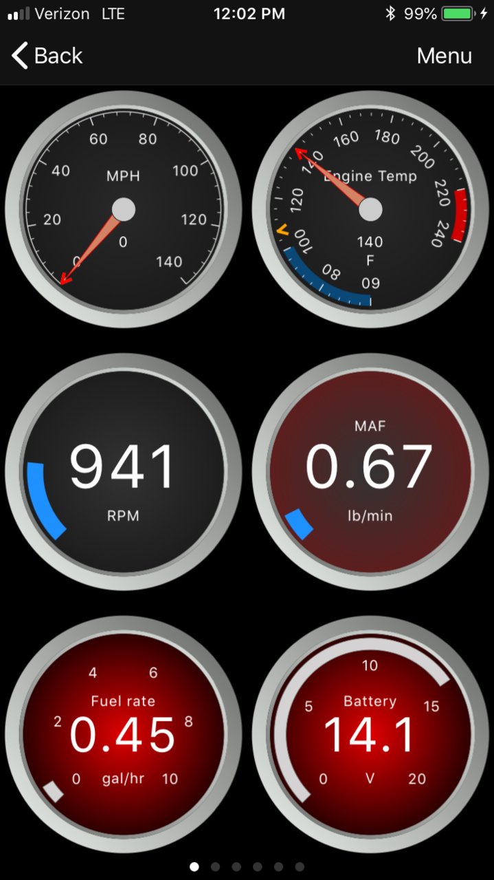

    Just fired the truck up to charge battery and let it idle with out touching anything.
    Ac off.
    The truck idles smooth and very consistently lowers idle speed as engine temperatures increased. Previously the idle would bounce around 2 to 300 rpm. Fuel consumption goes from .5 gallons an hour to .2. This truck can idle a log time if need be.
    The temperature gauge in the dash is just for show. It rose to the center position of its sweep around 165 to 170 and remained there until operational temp of 205.
