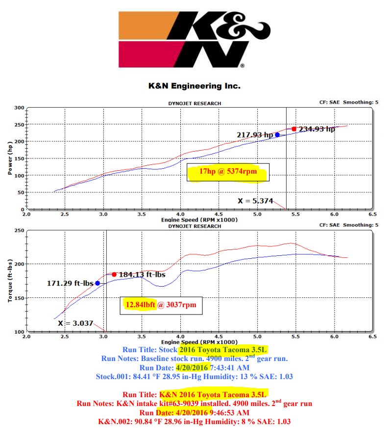

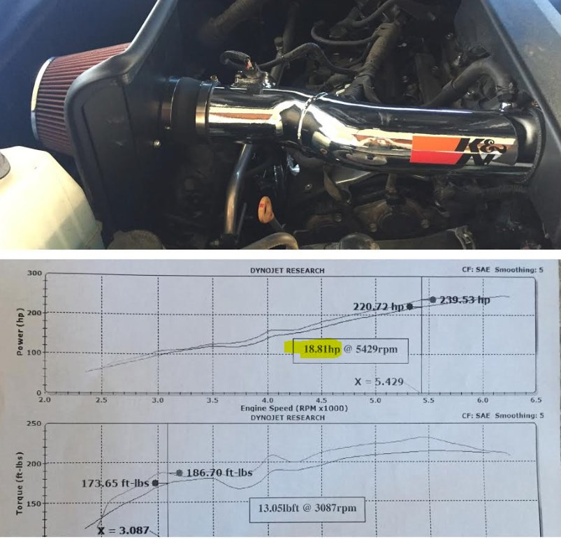

    @TacoSauceHB the 2016 tacoma is a 3.5l v6^ Not sure if referencing a different year or made a typo
    Edit-18hp just with a CAI is a huge improvment! Got any pics of the dyno graphs?

    . I hear that a lot on this forum, but you guys are missing the bigger picture with the aftermarket CAI's. It hyas nothing to do with temperature and everything to do with air flow. If you pop your hood and look at your stock intake, there is a huge box thing attached which is a charcoal canister for epa/smog stuff. That extra piece is very restrictive to air flow. When you replace it with a wide open pipe, it get a lot more air into the engine. Logic says this would cause 1 of 2 scenarios.
    A. The air/fuel mixture would become leaner.
    B. The MAF/ECU would recognize the increase air flow and make adjustments to air/fuel mixture accordingly.
    The K&N 77 series has a 18hp gain and they back it up with Dyno sheet from a 2016 TRD 3.4l. If you add something that changes air flow and horsepower/torque you would think that would also play into the tune right?. On my streetbike I had a tune and every time I upgraded something I would have to re flash it and list the modification. It always made a difference when I did that too. Not sure if this tune works the same way.

    lol I made 2 typo's
    *3.5L and it looks like its 17hp not 18.

    It seems like a lot of members read other threads saying CAI robs HP and kills MPG and brings in hot air so aka "waste of money" . Sometimes It pays to do your own research. I freaking love my K&N , sounds awesome and the power gain is noticeable. mpg also went up.

    They released a updated Dyno I posted above showing 17hp. close enough lol
