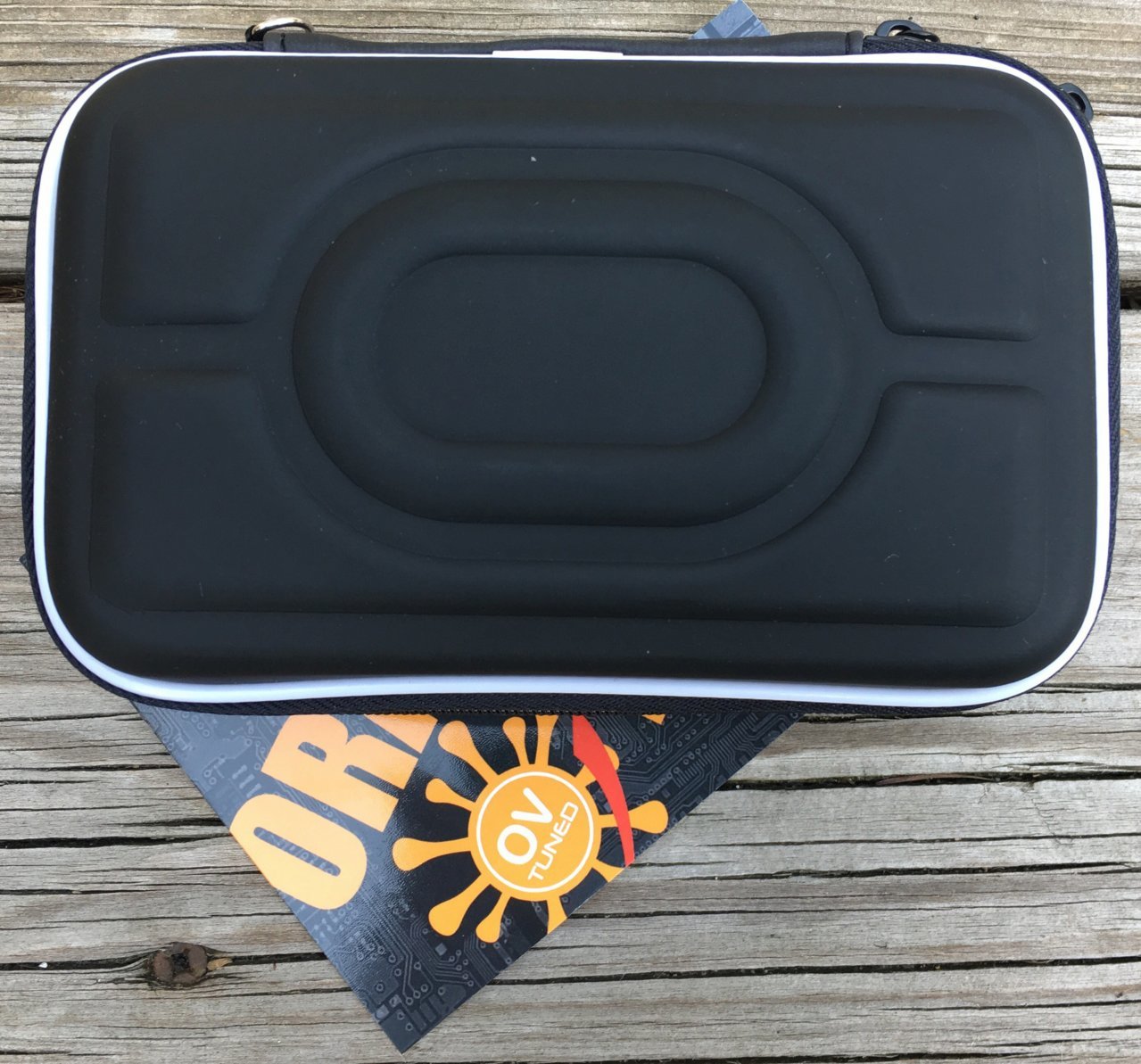

    Got my order today. Thanks Mat and @OVTune
