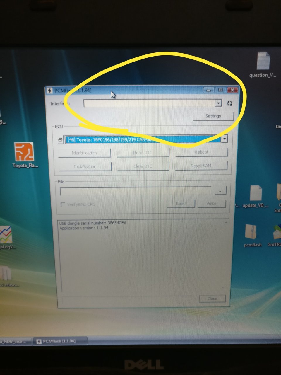

    Ok guys not having any luck on my end. Nothing appears under interface drop down. Dongle registered and just received pcmflash key and still no go. My laptop is on window Vista OS and have antivirus and defender off.
    Thought I post on here before bugging Matt. I'm sure someone on here has gone through this and don't really have the patience to scroll through all 870 pages in here.

    That only appears when your hooked up to the truck. Both dongles need to be connected to your PC as well. That shit had me suck for a min...

    Looks like its working man your serial # is down below

    :anonymous:.... Boy do I feel dumb lol

    Same. Nothing shows up in there until you’re hooked up to truck.
