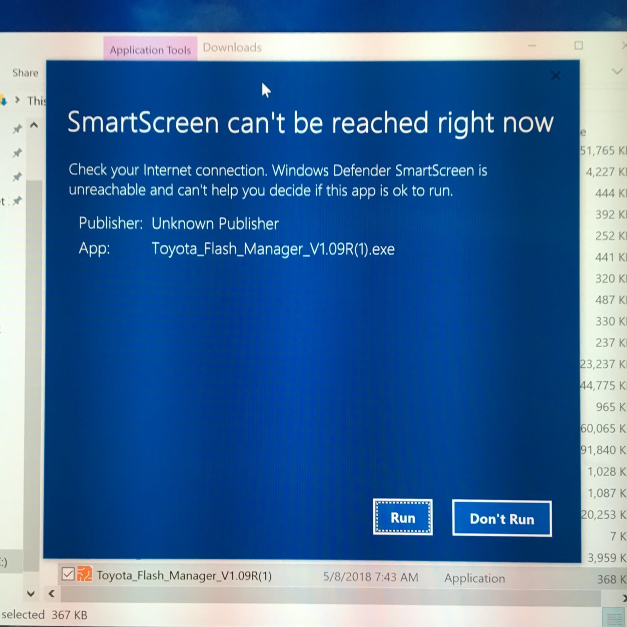

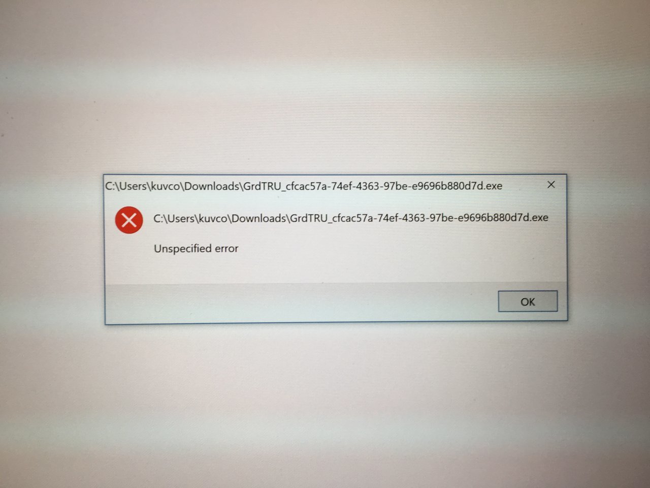

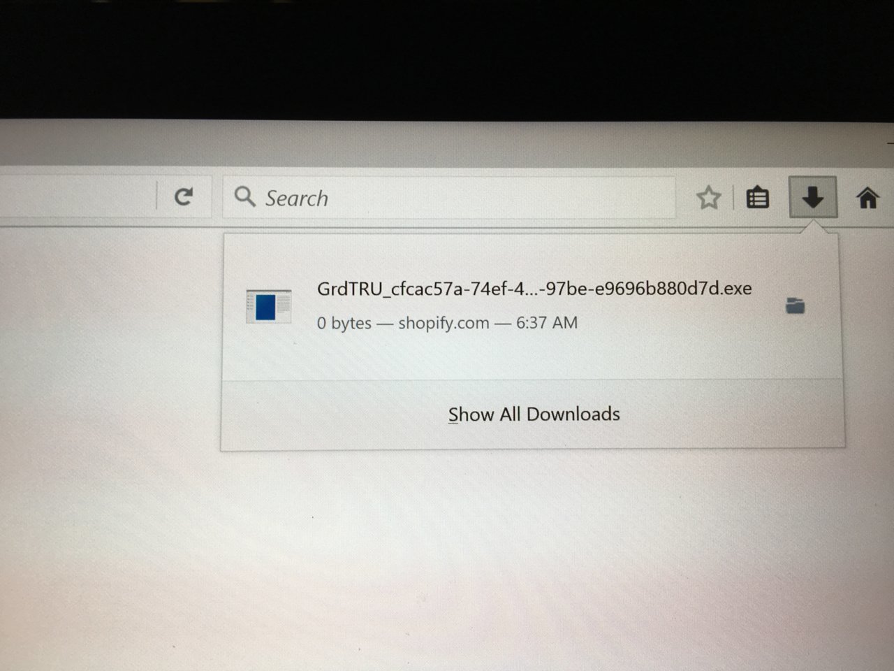

    Ok so I know these questions have been probably answered on this 894 page forum manifesto but I have to get some answers to install my OV tune I received a few weeks back. I know Mat is super-busy to answer my emails for help installing but tomorrow is my first day off of work in the past 31 days so I would like to install tomorrow if possible. Here’s a couples screen shots of the errors I’m receiving:
    982D327F-6C4E-4C4D-92BD-87AFC691386C.jpg 293EB37E-C614-46CB-BC54-C929ACB15B32.jpg ADC2B6B7-7076-403C-A75C-B692558B4724.jpg
    I need to get Mat my dongle info for its serial number to authenticate it to proceed. Any help would be greatly appreciated.

    Disable windows defender, that's the issue,
    I'm going through emails right now if you'd like more help via email
