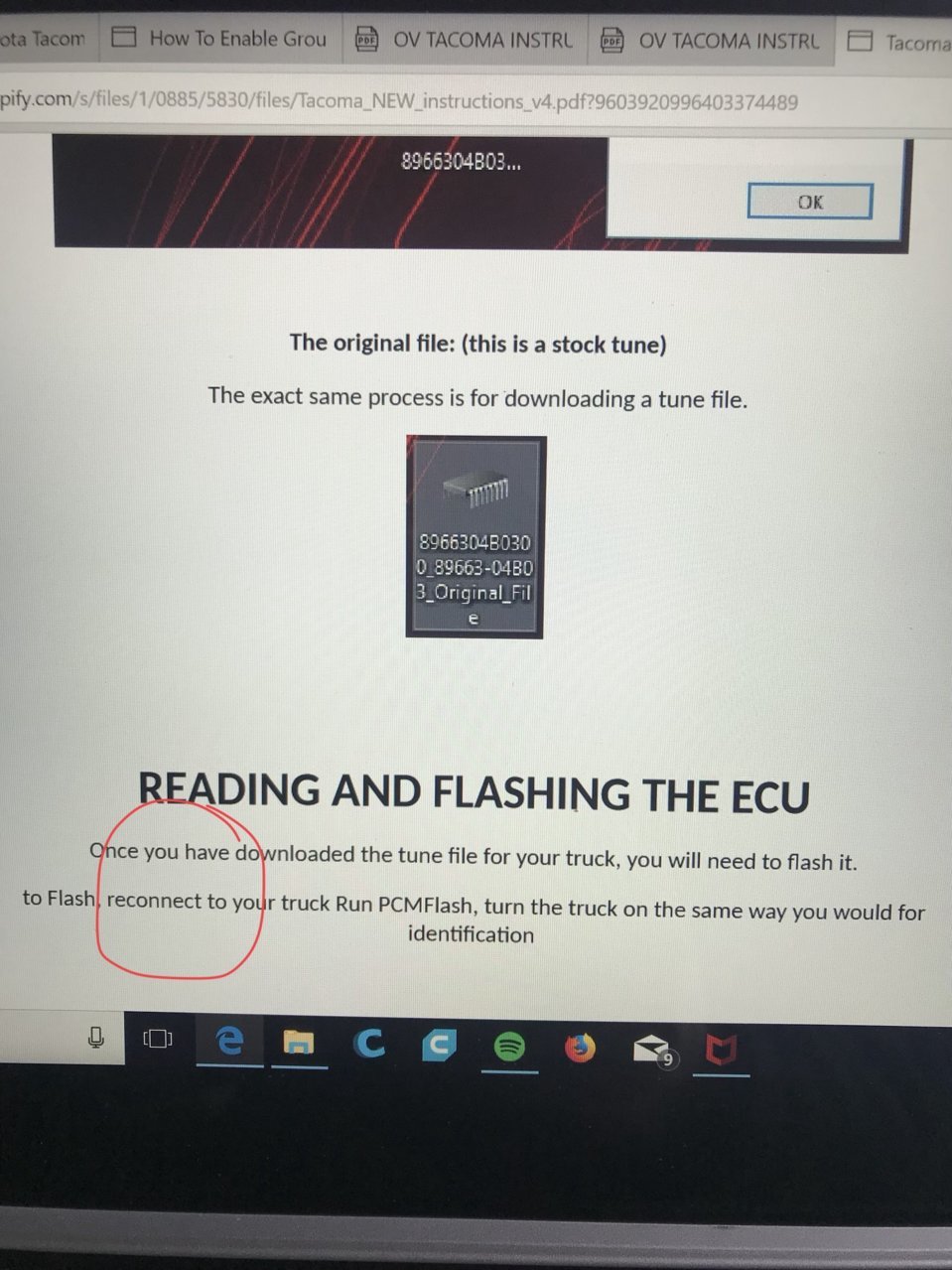

    This instruction says reconnect? It didn’t say disconnect anywhere after identification. I literally need every single step spelled out.

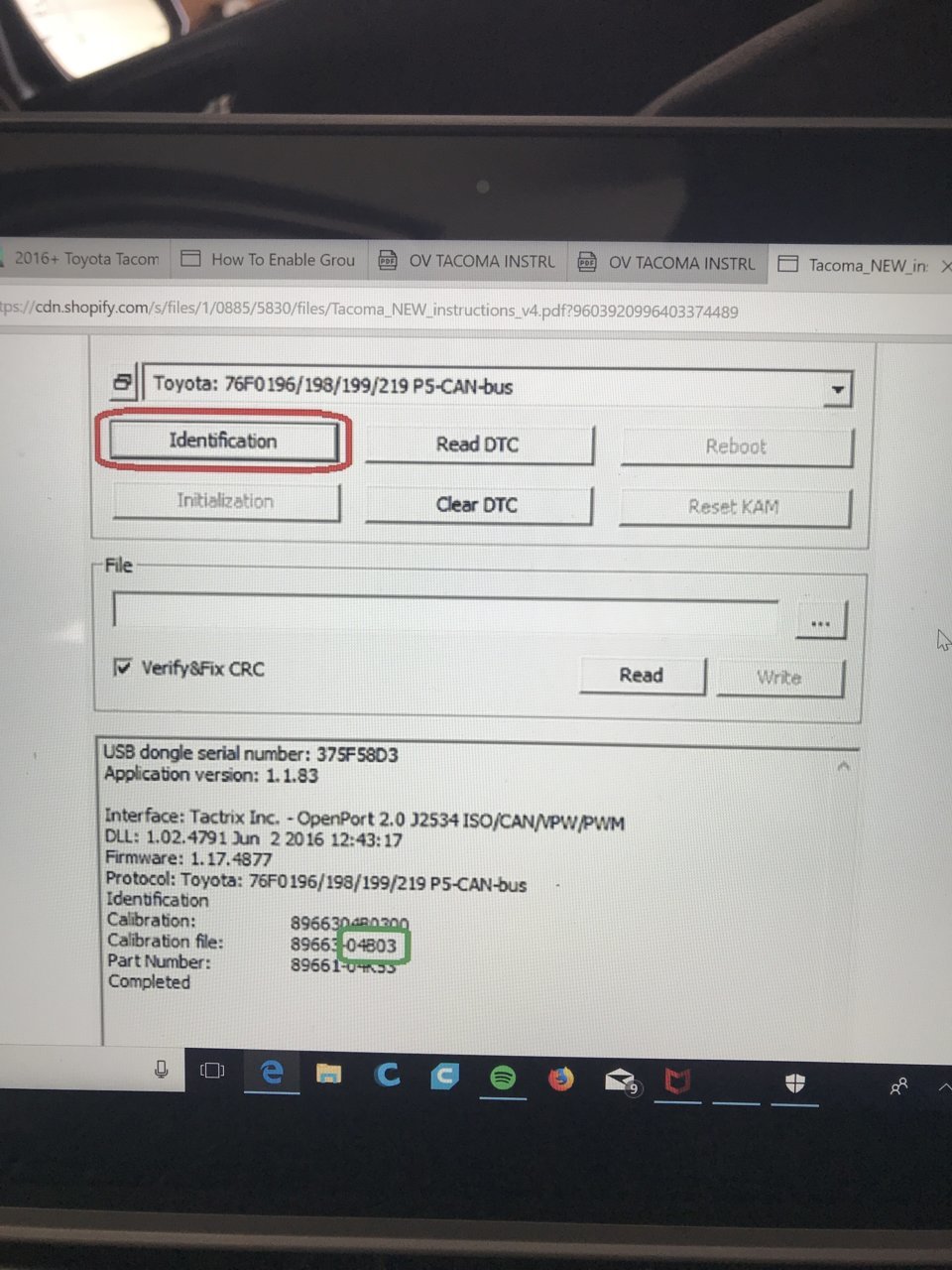

    What does “check your ECU version” mean? Do I just look at something and yeah that’s it or physically select something? And do I have to do this for both the ECU you and TCU? I just want this right and sorry for being a pain in the ass.
    After identification is there anything that needs done? Check the flash manager if the ECUs supported?

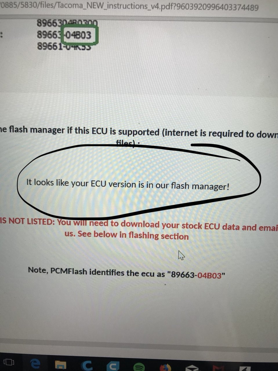

    Is there something like this suppose to show up somewhere?

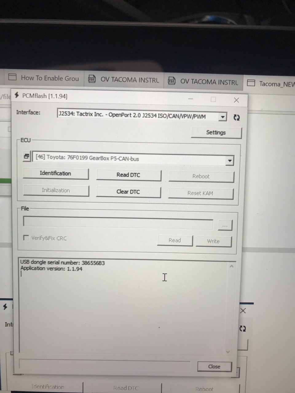

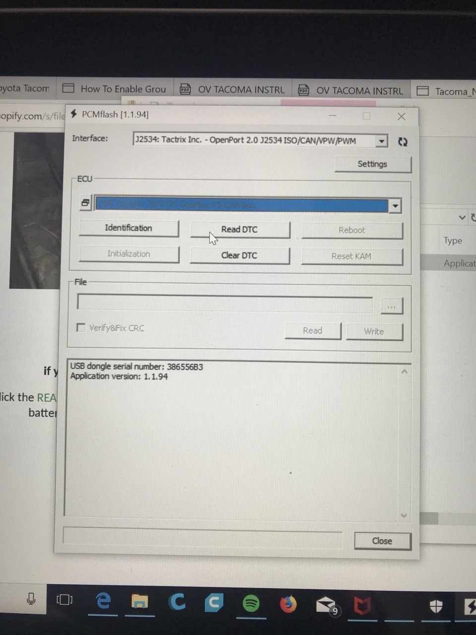

    Read is grayed out. I can not select it. What now? Thank you

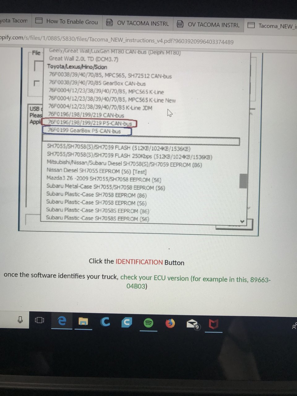

    The 3 ... box does not do anything. It’s grayed out like the rest. Also, noticed that it’s the Gear box on my drop down. Shouldn’t it be the main ECU can-bus?

    On the instructions page (attached) the read button is highlighted when doing the identification. Is this where you read the info?

    No. You don’t even need to read it since the stock files are already available from flash manager. You’re just identifying what ECU version your truck has so that you get the correct tuning files from flash manager. Once you confirm you got the correct version of the tuning file, just write.
