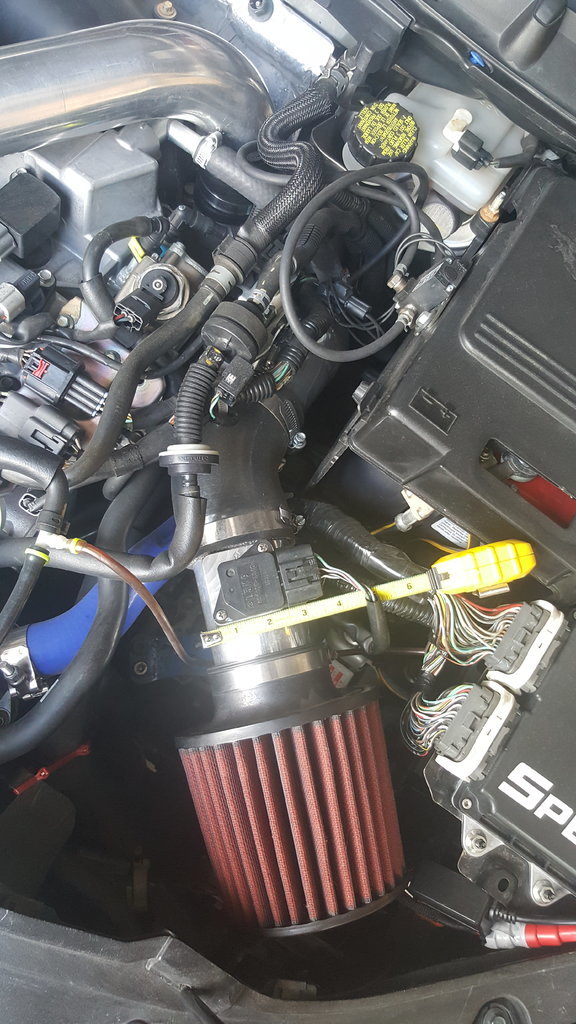

    Kinda like this? Had to calibrate my MAF A and B tables, watch LTFT and demanded A/F to take full advantage of the extra mass airflow to the 2871...Will there be much gain though on the N/A motor?

    @Area32 - does that MAF (assuming its a V8 MAF) make much difference?

    I do not know what a V8 MAF means. In my case I am running a 3" intake to a GT2871r turbo. More mass airflow + more fuel = more power. Granted this is in a F/I instance. On N/A id assume a power gain but not substantial. I could be very wrong though.
