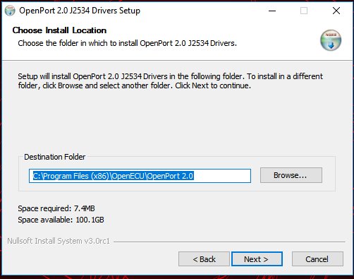

    I’ve got it to where it’s an uncompressed folder and the extract notification is no longer there. But when I open up the uncompressed folder the two applications are still there and when I install the drivers it’s asking for a location to install to and if it’s to the same OVTSoftpack folder it does not open up in p5flash. I still feel like it’s asking to directly install it to p5flash but it doesn’t give me that option if that makes sense.

    ah okay, just install it to default folder it lists. should be something like "c/program files/openport/ etc..." same like installing any program. I am a little confused on what you are trying to do. You just need to install the drivers, nothing else. The drivers are not related to P5Flash, you don't open it with P5Flash or anything like that.
    if you are talking about this screen, don't change the location just install to default location:

    Ok so I just downloaded the drivers successfully to the default folder. When I open up P5Flash should I see options in the interface box or not? As of right now I still don’t see anything.

    plug in the USB to the OBD cable then it should
