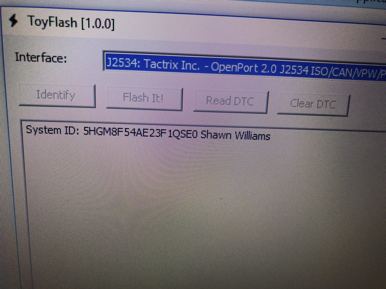

    This is what I am seeing when trying to identify my ECU. Still working at it but I think I am doomed:help:

    I noticed in your screenshot that is says ToyFlash (1.0.0). IF you have the dongless kit, did you download v1.0.9? I forgot to check what my version said at the top left of FlashManager when I retrieved my ECU ID.

    I downloaded what was on the dongleless instructions and followed that so I did download flash manager, the drivers and the pcmflash which is Toyflash. I also have no anti-virus installed on the laptop and disabled every piece of firewall or windows defender real time monitoring that I could find

    One thing I notice... my Sys ID didn’t have my name.
    Did you send the whole line w name to Matt or just the #’s... ??
