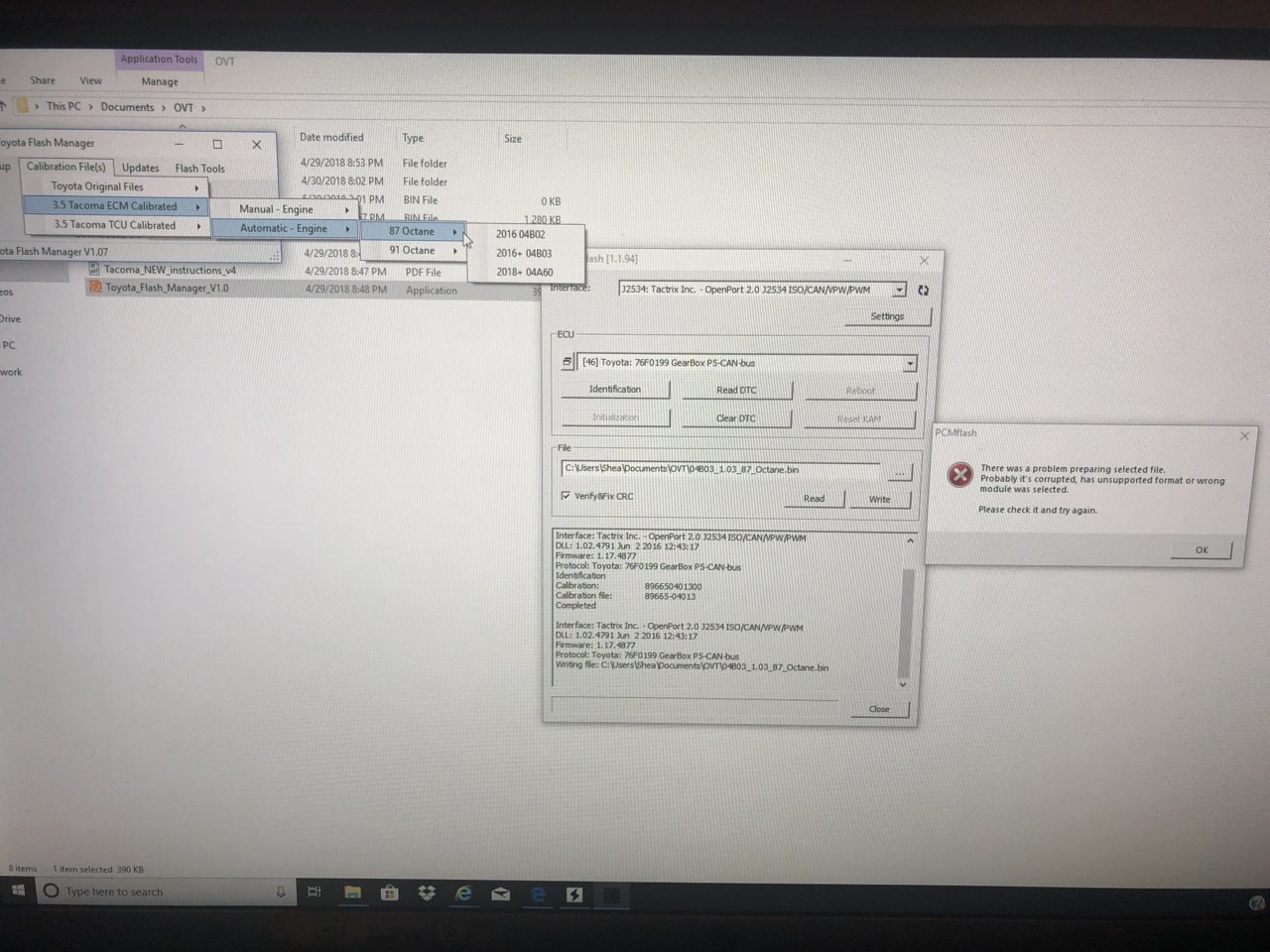

    Is anybody getting this error? I know someone posted a couple pages back, but I never saw a fix.
    All of this software has been saved to the same computer never been deleted and I have tried downloading tune files. All antivirus has been disabled.

    We never came up with a fix for it, he stopped responding. Did you install the drivers after downloading them?

    I got mine before installing the drivers??
    Did you download the tune files together as a zip or individually? If you did it as a zip try doing then separate

    All of the OVTune files I've downloaded and flashed to my truck have had .bin or .hex extensions. I haven't seen a .psf before, but maybe it's something new? Have you tried renaming the files to have a .bin or .hex extension?

    Looking at the pic, I think it is a p5f. That would make a bit more sense, but I still don't know if that is what it should be.....

    Anyone ever had this error message come up? If so, what did you do to fix it?

    Rename the file with a .hex extension instead of .bin

    Looks like you have the gearbox canbus selected, this is flashing the TCU. I believe you are wanting to flash the ecm which is the selection without gearbox.

    So looking at your path in the windows address bar, it appears you are trying to both:
    - Run "p5flash"
    - install the tune files
    from within a "OVT_Softpack" zip file. I could be wrong, but i'm comparing what you have to mine.. You need to unzip the "OVT_Softpack" zip file first.
    Can you share your a screen shot of your "Downloads" folder?

    The files are in an unzipped folder
