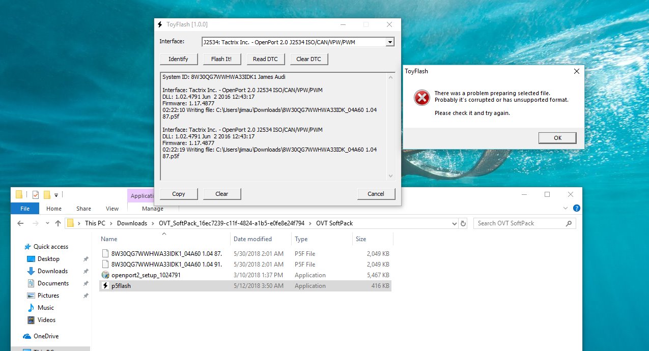

    Was there ever a solution for this error? I tried flashing last night and got the same thing. I know there was at least a couple of people that had the same issue, so hopefully someone figured it out
    I have windows defender, antivirus, etc. all turned off...

    Re-download? Try right clicking the p5flash and running as admin too.

    Thanks. I re-downloaded the tune file a couple of different times and tried running as an admin too. Got the same thing each time. I'm hesitant to download the p5flash and drivers again since I believe it was recommended not to awhile back

    There was never a solution that I could come up with, downloaded, re-downloaded tune files. Fiddled with windows defender until I manually disabled windows defender in the registry. Thought there could be a naming issue with the file as it did not match my system ID (missing a #). Switched USB Ports, put on a tin foil hat, stood on my head, removed my kitchen sink etc.
    This system is similar to some that I have used in the past when developing software for some video game addons (hacks) so I went through as many of the troubleshooting steps as I could remember from those days. I have a pretty good guess whats going on, waiting on Matt for a reply.

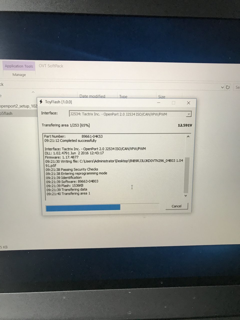

    So, I successfully flashed my ECU with 1.04 this morning following the dongle-less process. Was super easy following the instructions using a Lenovo LT on Windows 10 with windows defender disabled and by running P5flash as an administrator.
    To be fair to Mat and everyone else following this thread, here is a summary of my experience from purchase to flashing:
    5/10/18: Ordered
    5/21/18: OV tune kit arrived & System ID emailed
    5/23/18: 2nd request sent with System ID
    5/28/18: Tune files received
    After travelling, I was finally able to install this morning, 5/31/18 and results of the flash are shown in pics above.
    Truck is idling now (not sure if this is required since it's not in the instructions, but did so after reading what others did). I will drive and post feedback on the 91 tune.
    EDIT: drove it through the hills and let’s just say it drives like a champ. You should’ve seen the smile on my face. No more lugging, bogging and embarrassing “I think I can” moments so far!! :thumbsup:
