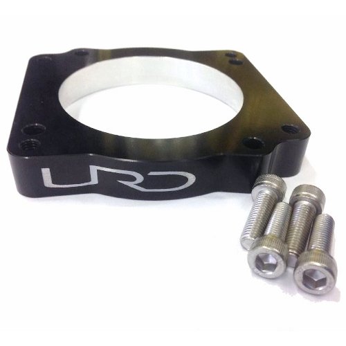

    Must be something to it if URD has made the spacer for it! Dam MO MONEY MO MONEY!

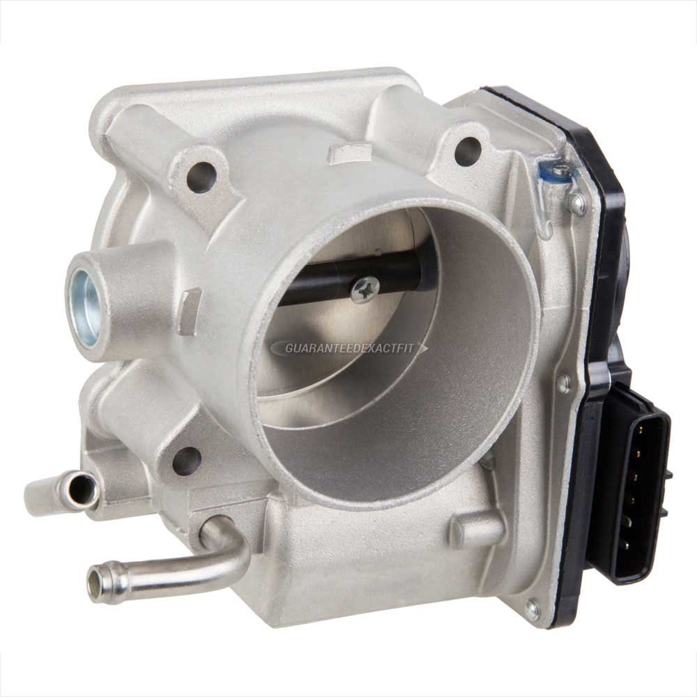

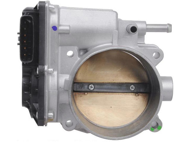

    Dammit, you can't keep shit like that to yourself, you should have told us this weeks/months/possibly years ago.
    Looking for throttle body now!!!!
    Go! Go! Go! :thumbsup:
    **Edit**
    Stop! Stop! Stop!
    Holy shit! A new throttle body for the 2005+ 4.7L Tundra is $700+. WTF! Am I reading that right!
    Part #22030-0F010
    Is it just because it's a vechile they don't make anymore or something, or is it a Toyota thing? $700+ for a throttle body?!?!

    Do you think we could see any more gains in low end torque from a larger bore throttle body and longer intake runners in conjunction with your tune?
  18. Jul 16, 2017 at 5:56 PM
    #1798
    OVTune
    OVTune [OP] Well-Known Member
    Mar 27, 2017
    #214557
    8,112
    OVTune
    Probably not. The engine acts very similar to the FSE. I did a lot of airflow testing on that. Ultimately it was never a breathing in problem, but a breathing out problem. Stock Toyota vehicles exhaust systems are literally choked. Even the tacomas
    Our second stage camshaft adjustments and aftermarket exhaust will be the most beneficial in my opinion.
