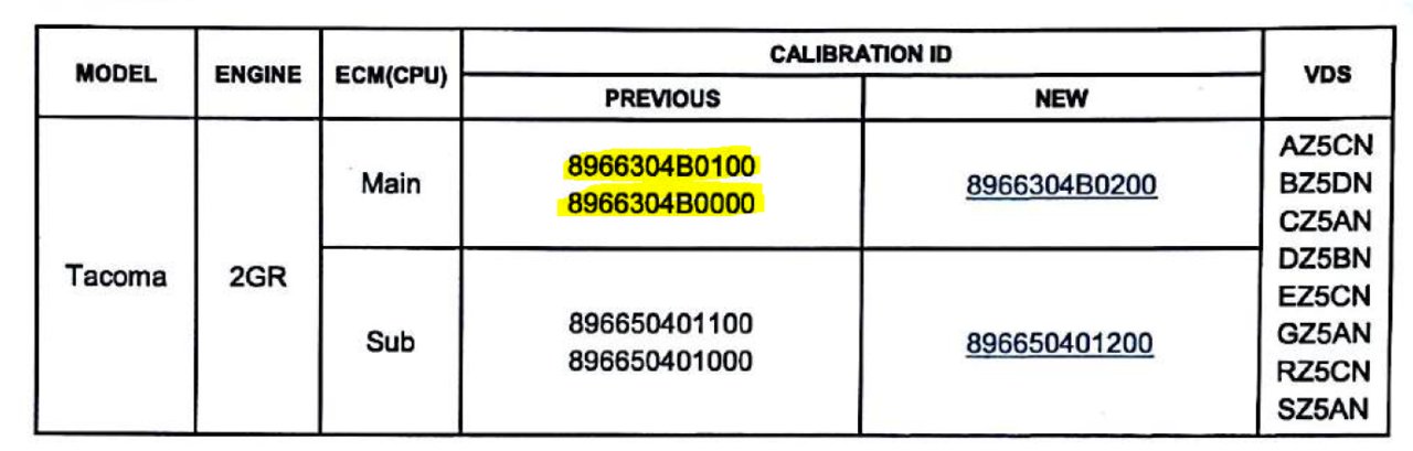

    If you scan your car's ECU and see this:
    Interface: Tactrix Inc. - OpenPort 2.0 J2534 ISO/CAN/VPW/PWM
    DLL: 1.02.4791 Jun 2 2016 12:43:17
    Firmware: 1.17.4877
    10:43:51 Identification
    Calibration: 8966304B0100
    Calibration file: 89663-04B01
    Part Number: 89661-04K51
    10:43:51 Completed successfully
    And the Calibration number matches this:
    Then you're eligible for the recall.
