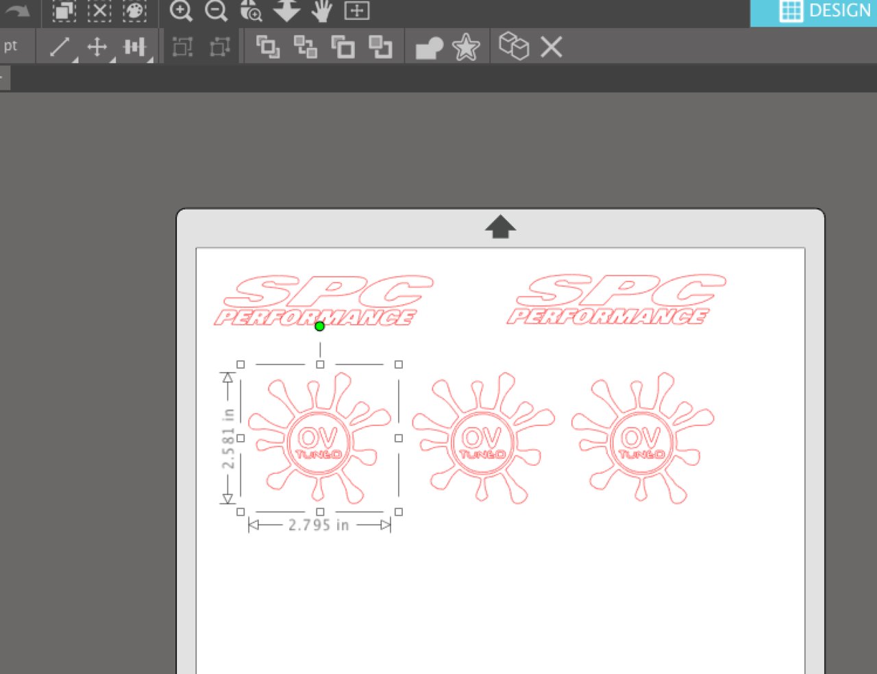

    ...i was just working on this file for my vinyl cutter when i saw your posts above
    making a SPC one as well (they did send a sticker but i lost it)
    not a really clean trace due to using a low resolution image.
