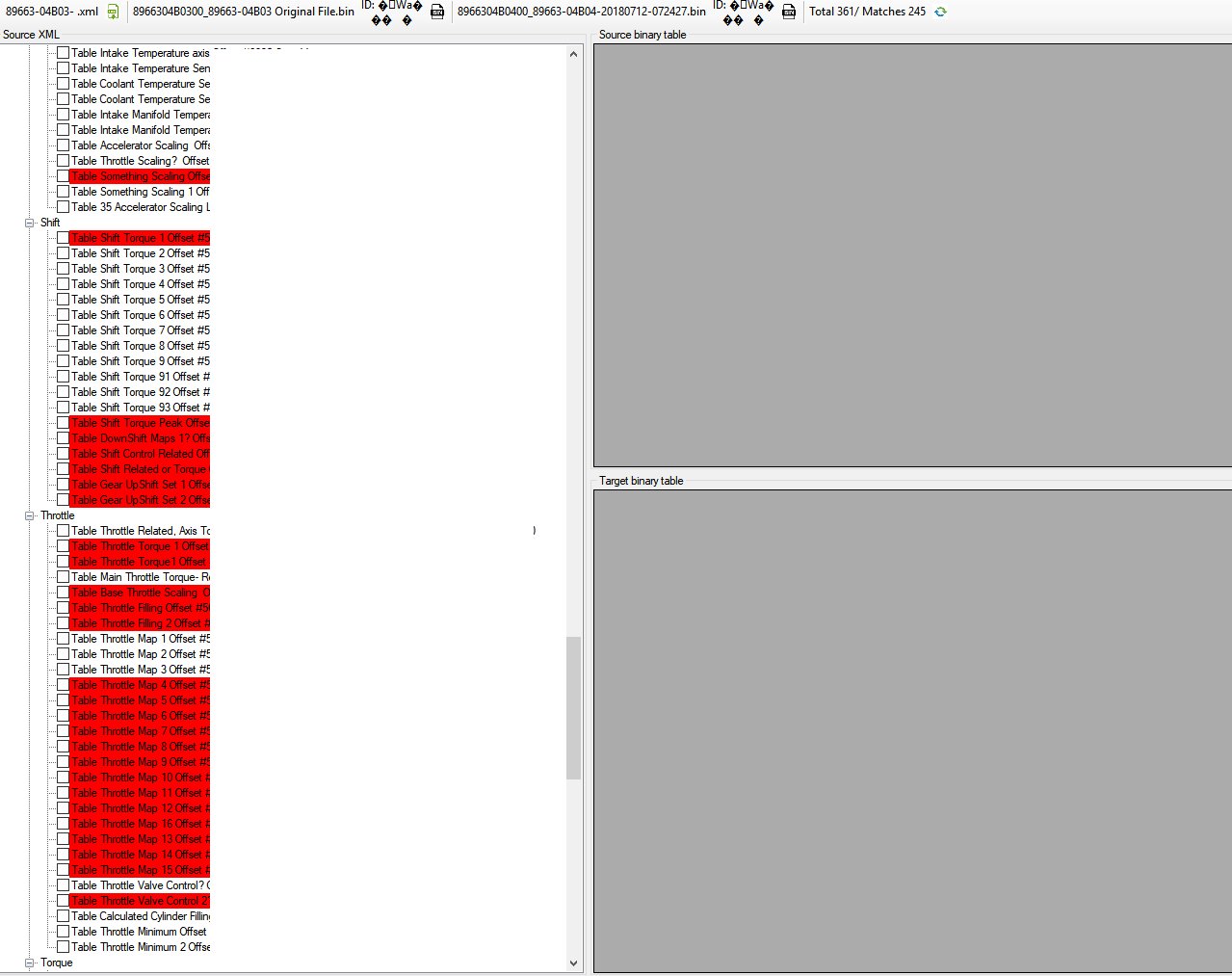

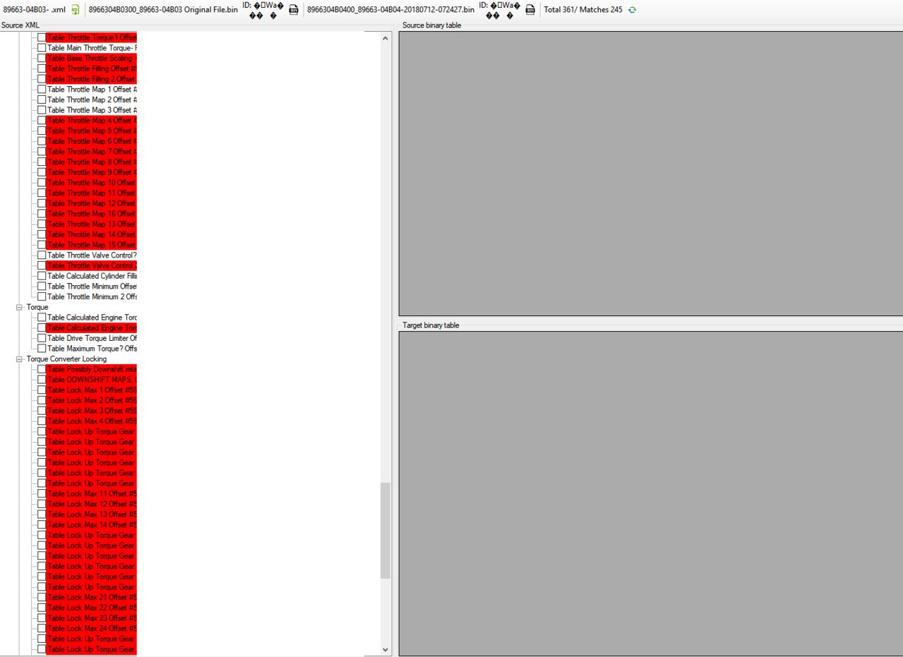

    Okay, guys, thrown 04B04 in my autocal tool for check vs 04B03.
    What exactly was toyotas "update" for? The Torque converter. There is a massive amount of changes, much more than just Torque converter locking. (had to cut off offset addresses sorry).
    Due to the amount of changes we are looking at 7-10 Days for 04B04 support. I've got to parse through 100+ changes
    Throttle changes, Valve timing changes, ignition changes, tons of lock up procedure changes, shift table, torque.
    Toyota threw everything into this one
