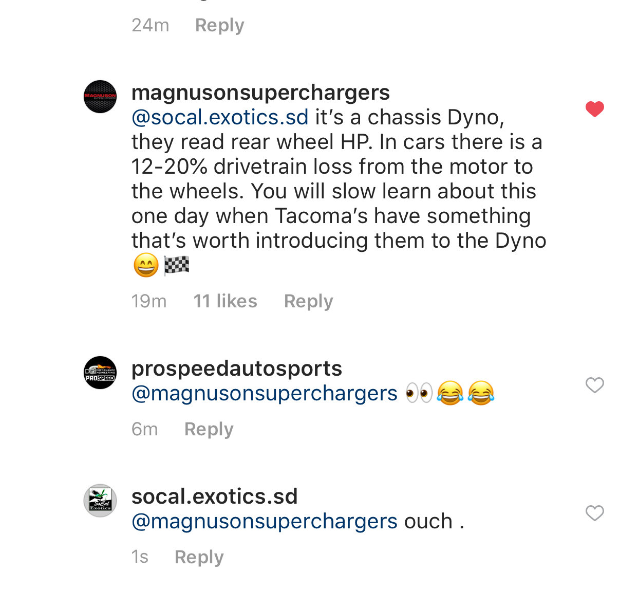

    Lol they supercharged a camero and made 650hp at the wheels and i told them isnt that what they make at the “crank”.

    Tell them "yeah, when the twin turbos drop in a couple months"

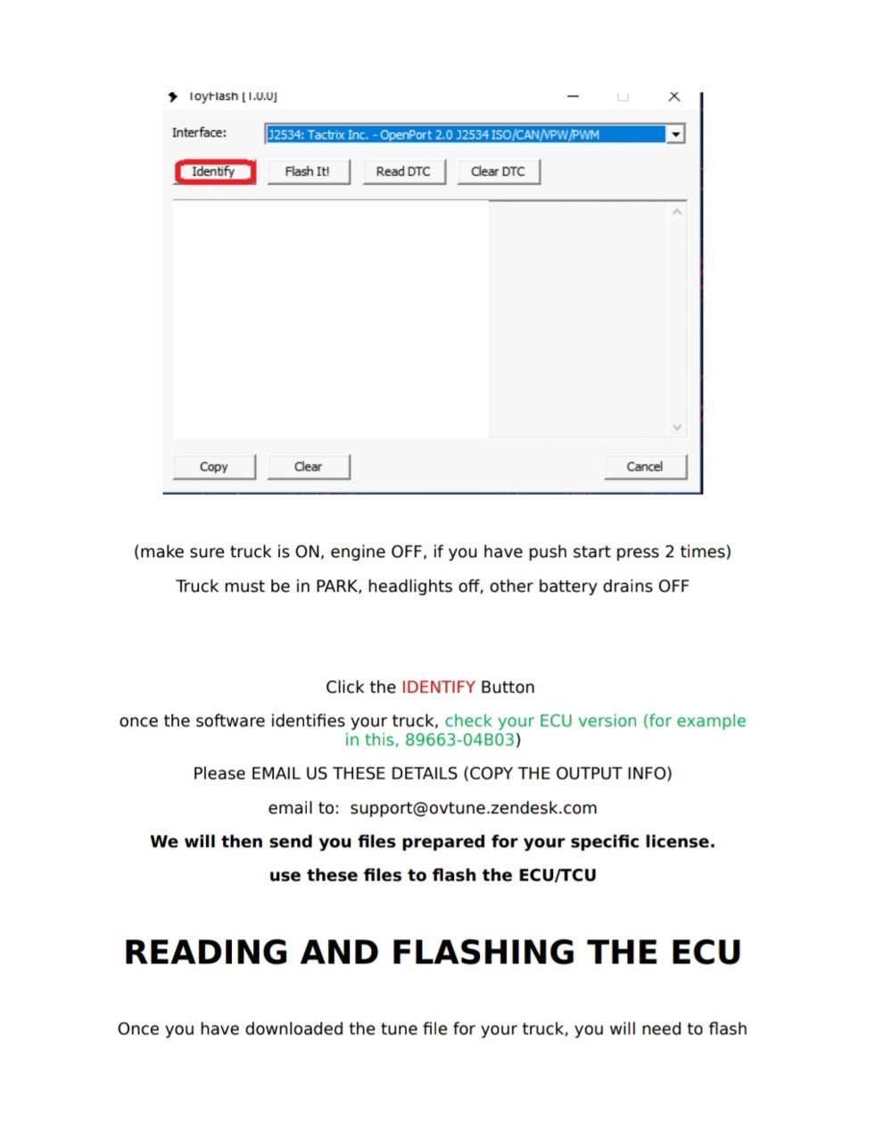

    Did you add the key to your registry? If so then you are on the "Identify" step in the picture. Ignore the Flashing Your ECU partSmartSelect_20180726-170311_Drive.jpg
