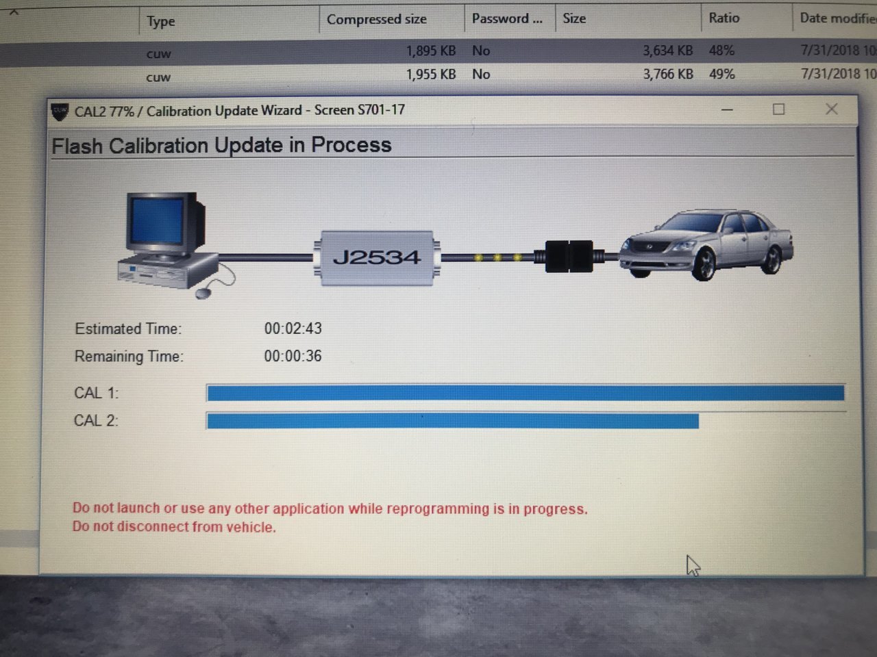

    So after you unzipped the cuw folder you just clicked on the correct for your vehicle file after having the laptop connected and it loaded its self. Am I under standing correctly?

    I have the older version of TS many have on here installed, but I did not have to open it for the CUW files. Literally idiot-proof... plug in tactrix, click CUW file, hit a couple of buttons and in 6 mins was updated to the latest calibration. Will probably curse this decision when driving in traffic in the morning but I can suffer for a few days since Mat is releasing 1.04 for the new calibration this weekend.

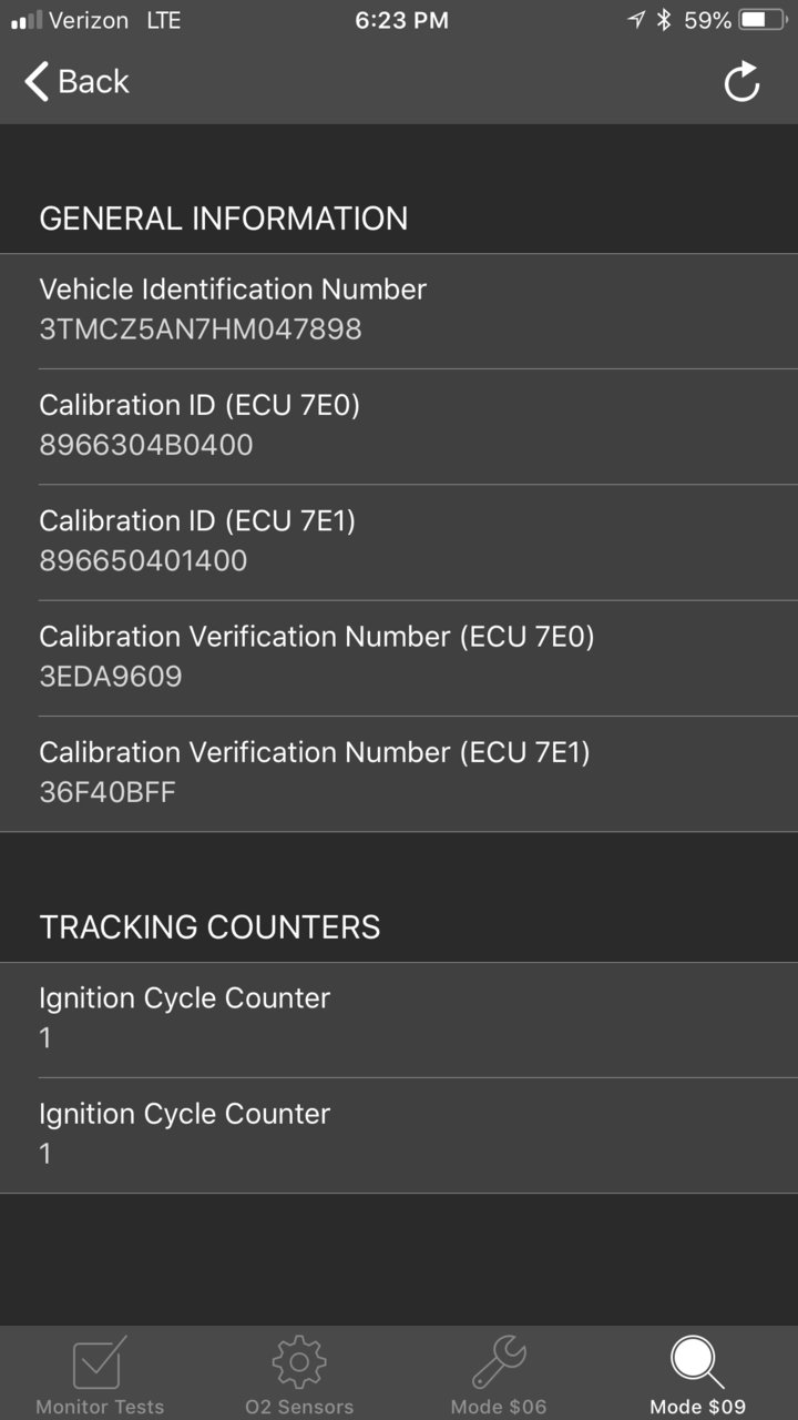

    Yes Calibration ID Changed to 0B0400. I assume if you had the previous CUW files you could change back and then be able to run the OV Tunes that were developed for those ECU IDs.
    Yes. The CUW file is an executable that launches an update software. You follow the instructions and it does its thing.
    Techstream is not needed unless you are going to use it to download the latest files. If you did that you have to have a membership to TIS. The CUW file launches and that is all that is needed.
    TS is not really needed for anything other than monitoring sensors and systems. Unless you wanted to change some things like seat belt chime.
    Yes. I used the one that was posted.

    Cuw file will not launch without Techstream on the laptop. At least on a win10 box. Windows said not recognized file. If you have TS on the laptop and click on the Cuw file it runs and auto opens TS.
