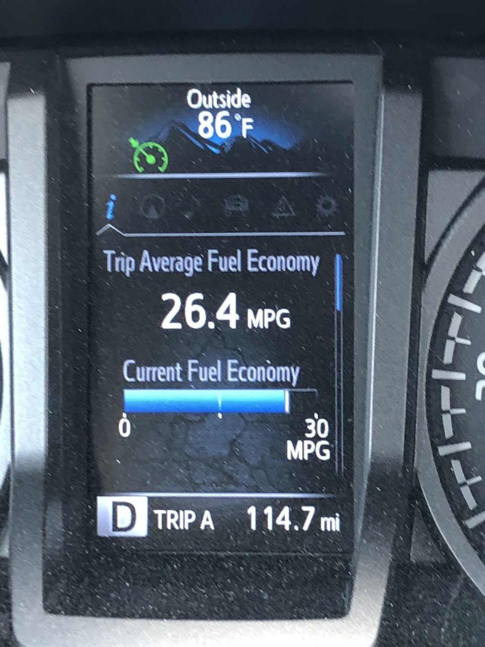

    Still can’t believe how much better fuel mileage is. 63 miles an average on this trip on mostly flat northern Indiana highway. Running 104 91 tune with 93 octane. Before Ovtune I could not get over 19. Even when I hot rod this thing I can still get 19. Stock vehicle with stock tires. Also, truck sounds so much better on tune. Sometimes it’s hard to keep your foot out of it!
