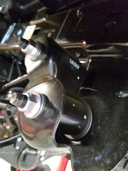

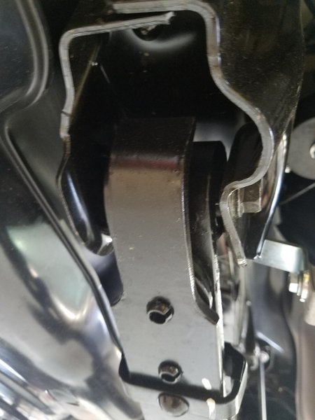

    I also own a Pro. This is what I did to make the squeak go away. granted we are talking about the same squeak. All I did was spray wd40 on the front and rear bushings of the leaf springs of both sides. and it goes away..
    For the whistling noise there is a TSB fix for that
    BTW is your car a 6spd or auto?
    ill post pictures in a bit... maybe
  13. Mar 10, 2017 at 9:59 AM
    JINeration
    JINeration Well-Known Member
    Aug 15, 2016
    #194657
    156
    Jin
    Mckinney, Texas
    2017 Toyota Taco
    Hot off the press of the stall next to me.
    Just spray wd40 into the bushing and not the springs itself
    StevieCruster likes this.
