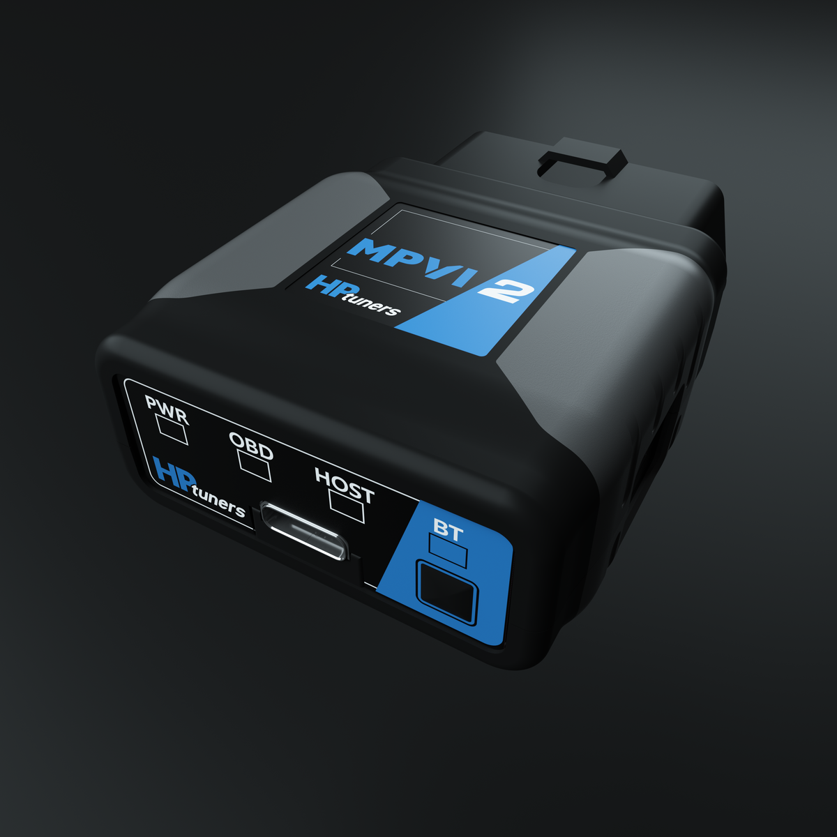

    You would need an HPtuner to pull the file. You should get one anyway so you can get a trans tune on there which would probably help immensely.

    Did they give you the HPTuners RTD device? It would be a little module that plugs into your OBDII port. It looks similar to the MPVI2
    If you have that, you can install the VCM Suite, and use the VCM Scanner in combination with your HPTuners RTD and datalog. Email me the datalog file and I can provide some insight as to how the tune/combination are working.

    yup they did whats your email justin?
