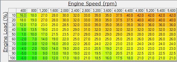

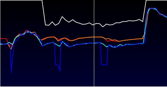

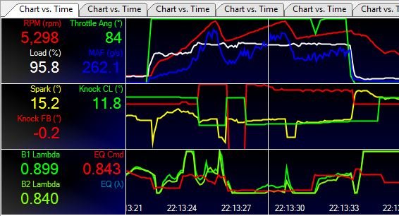

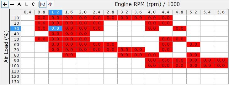

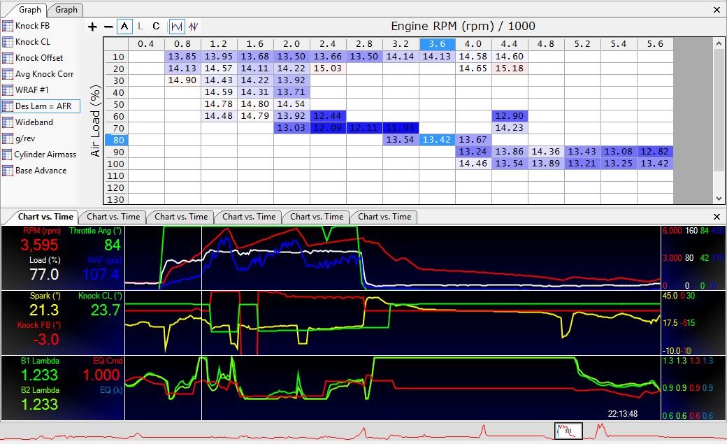

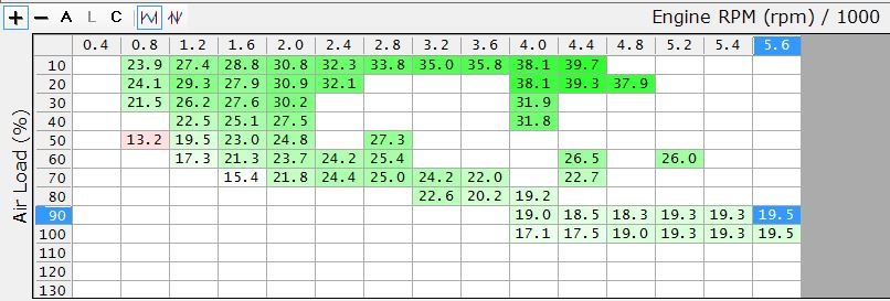

    The ProCharger tune is "interesting" to say the least. I think a custom tune would do a lot for the performance of the kit, but that's easy for a guy like me to say.. I'll post up some of the data here to support my statements.
    Fueling:

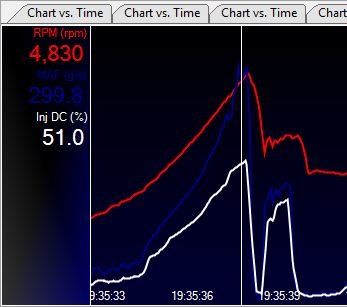

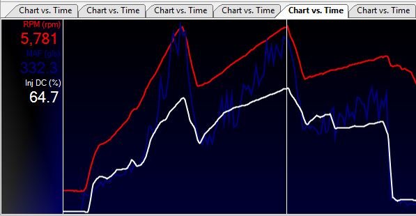

    The first thing that jumped out and grabbed my attention was the Commanded AFR under WOT load. The Graph below illustrates these commanded AFR's. If you look a little further down at the Chart vs Time, you can see there is some alarmingly lean conditions present in certain areas of the tune. At that point the truck goes lean, there is also some throttle closure happening. I'll show that in a separate Chart vs Time screenshot below the fueling
    As you can see from above, the fueling is a little concerning. The commanded λ values are QUITE lean in certain areas of the tune and even under sustained load the tune is still on the lean side as seen here:
    Fuel trims are generally acceptable, so they've got the main injector scaling pretty dialed in I'd say. However, there are some very large "holes" in the MAF calibration curve. The graph below will show you the sum of the fuel trims versus the MAF voltage, giving you an indication of the percentage error present in the MAF transfer function. The bulk of the function is pretty close as you can see in the lower MAF voltage cells. But as you approach 2.50v - 3.44v, there is some serious discrepancy. The MAF calibration could definitely use some work in this area to improve fueling.
    Further more on the MAF calibration, the airflow seems very 'choppy' and erratic. At higher airflow levels you will occasionally see oscillations, but the airflow 'curve' should be smooth. I'm unsure of the cause, as it could be something mechanical (leak/obstruction/etc) or if the MAF calibration is not smoothed. Either way, with the MAF reading that erratic something is 'off'. Just for illustration purposes, below is the ProCharger setup/tune and a URD Mk3 setup that I'm currently tuning
    ProCharger: URD Mk3:
    ProCharger did do a fine job spec'ing the injectors. They seem to be appropriately sized for the kit as supplied and even have quite a bit of headroom for future growth.
    Ignition:

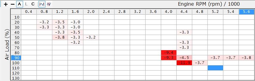

    The tune seems to have a timing map that is fairly close to stock N/A values. The actual amount of timing the engine was seeing was about 3-4deg less than the Base values due to Torque Management pulling timing at WOT, reducing engine output. I'm not sure if the approach ProCharger took was to let the Torque Management system remove timing from the truck or if the torque tables were not addressed fully. But there is a bit of torque management being applied at WOT to reduce engine output.
    Torque Mangement (White line) pulling timing from the ignition maps (orange/red lines), Blue lines are ignition values as delivered to the coils:
    Additionally, there are some serious instances of knock feedback at particular RPM/Loads, but I don't attribute the detonation to the timing values that ProCharger spec'd for the tune. I think the issue is more on the fueling side. I think the timing map is fine for a stock truck running a centrifugal SC setup and ~7psi or so.
    The areas of concern are right there in the meat of the powerband, 4K-4.4K RPM at high load. You can see the knock retard averages below:
    The base timing map values compared to a stock N/A map:
    VVTI:
    ProCharger has elected to completely disable the VVTi system, effectively setting the entire map to "0". This neuters the powerband, specifically in the low-midrange RPM/loads.(Ask @Torspd about that..) I feel this is really holding the kit back below 4000RPM.
    In closing, I think there's quite a bit more to be had with the kit. The tune leaves some power on the table in my opinion.

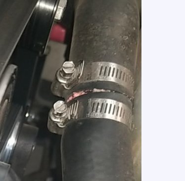

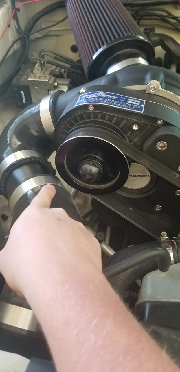

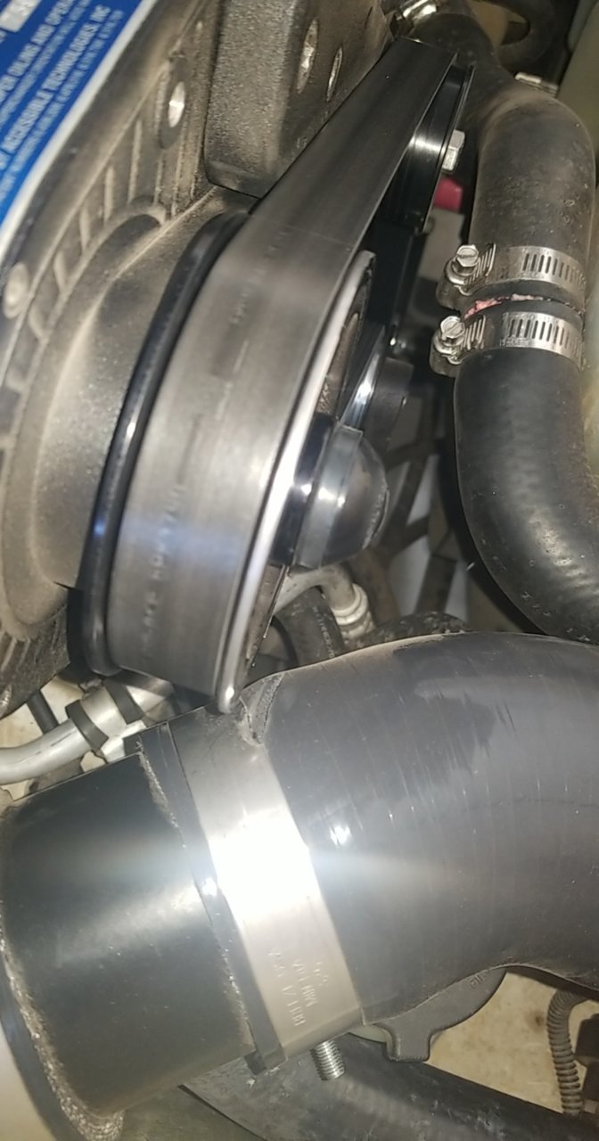

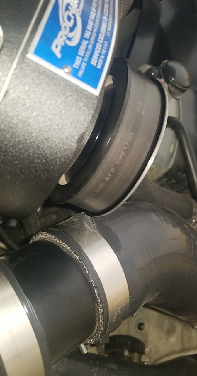

    You can see where the pulley is actually missing paint from hitting that clamp but that's all I can see from the outside. I noticed some wet spots on the ground so I look under truck and in multiple spots there is pink liquid everywhere and I look and my coolant reservoir is almost completely empty. Could a coolant leak cause my problem?
  11. Sep 29, 2020 at 12:32 PM
    #231
    PhoS
    PhoS Proffauxssional
    Apr 8, 2020
    #324146
    1,317
    PNW
    08 FJ Cruiser
    Contains MSG
    Coolant leak could be here? This is the only hose you have to mess with to do the install. That could also be remnants from the swap.
    You can pull that elbow out from the supercharger outlet side a bit to make more clearance for the pulley.

    Yup coolant is coming out of the bottom of where those 2 pipes meet

    Is that coupler still able to seal or is it just surface damage? If you've got a leak, that might explain some of fuel trim error (MAF calibration concerns). However the commanded AFR's of the tune are still questionable at best, and that wouldn't be affected by anything under the hood.
    The wet spots are from that splice in your coolant hose. You can see the residue on the union in-between the splice point.
    I went back through your logs and your coolant temps are stable right around 194deg F which is normal for a stock setup. The empty reservoir is likely due to the system pulling coolant to compensate for the loss caused by the leak. The coolant leak would not play a factor in any of the tuning items I mentioned above.

    All the way through, there is my leak. I have a warranty so I can get a new piece
