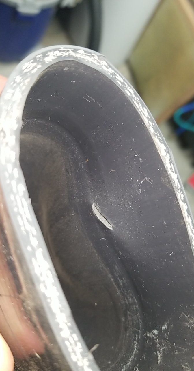

    Well got the piece changed and there is a nice half inch gash inside the tubeSnapchat-950231705.jpg

    Well it looks like the pulley is still hitting the tube as there is a little mark on it, luckily it didnt cut it again. Any suggestions? It looked like WOT the head unit moves enough to hit it

    Looks like a smaller pulley is your only option... :burnrubber:

    Did you pull the connector further out on the SC outlet?

    I tried but there isnt a ton of extra tubing honestly. how much are new engine mounts?

    Sorry if this was mentioned already, but was Procharger notified and were they the ones that sent you the replacement hose?
    Personally, i would get another 90deg silicon hose with longer ends. Cut it to match the bend but also pull it away from the blower outlet a tad so there's more gap between the pulley and hose that's its rubbing on. (Also think about getting another replacement hose if the "new" one is damaged again.)
    I would also consider stepping down to a smaller pulley in combination to the above if clearance is still an issue. But i would rather squeeze and manipulate those silicon couplers to gain the clearance that you need.
    IMHO, the last resort would be to replace motor mounts or stiffer urethane mounts in addition to above.
