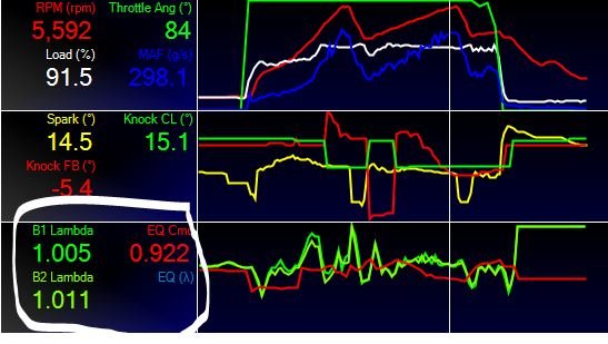

    Just finished my first round of tuning just @JustDSM and I would swear it was a different truck. Sent my logs off to him so we can see more in depth how it was but I am more than impressed

    I was just about to ask how the tuning was coming along. That one hose was creating that much of a problem alone, or did y'all also tackle the fueling and VVT profiles to really wake things up?

    All of the above. The leak, VVTi, fueling, timing, etc were all addressed.
