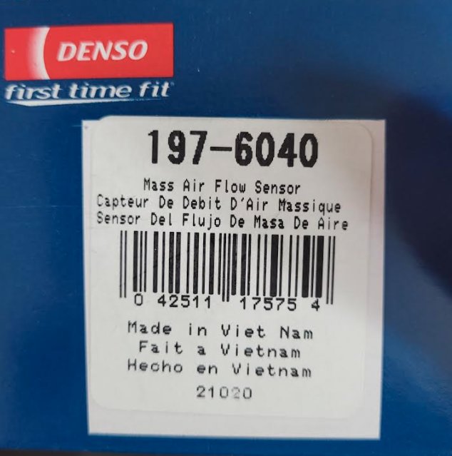

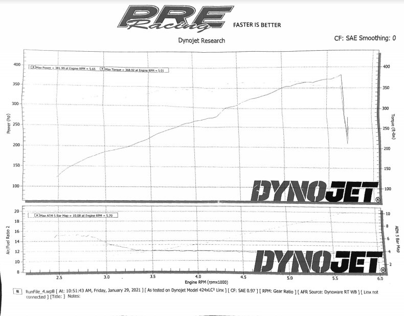

    Got re-tuned today with a different MAF sensor/housing. It made a couple more ponies surprisingly now 381hp/368tq :headbang:
    For the curious we switched to the Denso "197-6040" in a 3" housing. I had the stock "197-6030" in a 3.5" before but it was maxing out. The new sensor didn't max out even in the smaller 3" housing. (at least not at my airflow levels) Rescale as needed.

  11. Jan 29, 2021 at 3:08 PM

    That's great news!
    I take it the newer part number is a higher resolution MAF sensor then. What is it out of?

  12. Jan 29, 2021 at 3:11 PM

    Exactly, it's OEM from a newer Subaru.

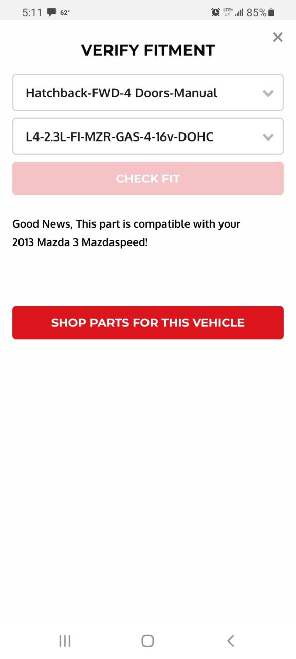

    Ahh! Did a quick search and found that the sensor is also used in the Mazda speed 3
    Smokehouse likes this.

    Yea it's just off the shelf, I'm sure they use it in a bunch of stuff. Lucky the tuner recognized it and knew about the alternative. Plug and play and rescale otherwise. Definitely better drivability vs. stock with big housing.

    :benchpress:
    Now those are some numbers!!
