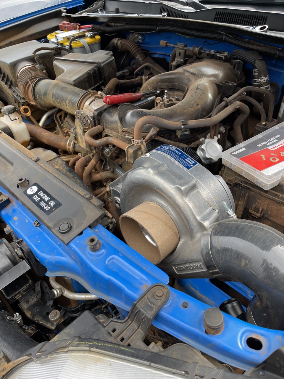

    Got my Procharger in. Got everything from the crank pulley, supercharger bracket, piping from supercharger to intercooler and intercooler installed. Just at a standstill until I get my software registered through OVtune so I can get my tune before I button the cold side of the intercooler and route the belt.
    Don’t mind the dirty engine bay, the last rain storm was too much temptation to go play on some trails and haven’t gotten to cleaning yet.

    Welcome brother!

    Been lurking since I bought the truck new just been itching for boost since I got out of my Subaru STI build. Glad it wasn’t too long of a wait till a supercharger was available for a 3rd gen

    Excited for you bro. Does it call for a different weight oil for 3rd gens or still use 0w-20?
