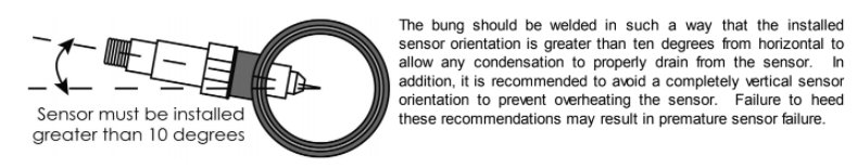

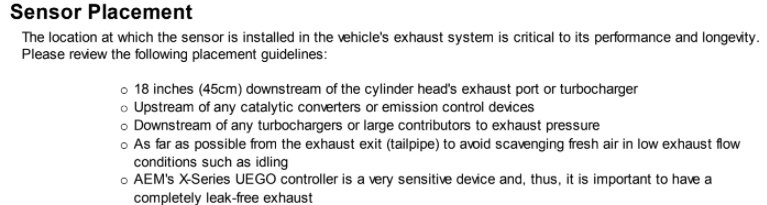

    Ehhhh, Yes it should last longer but how long it lasts depends on many things and this is why AEM might try to tell you to take a hike. My original AEM sensor out of the box only lasted a few months. I picked up another Bosch sensor and this one has been fine ever since, but I got a 2nd spare JIC.
    A. Is is installed correctly? These sensors are extremely sensitive to bung placement. I'm sure you saw the notes in the instructions about the sensor angle, where did you install it?
    B. You generally shouldn't have the sensor heated without the truck running. I'm pretty sure this is how I fried mine as I was spending a lot of time truck off with the HP tuner.
    C. An overly rich tune is can foul the sensor.
    D. Act of god?
  15. Apr 29, 2021 at 6:42 PM
