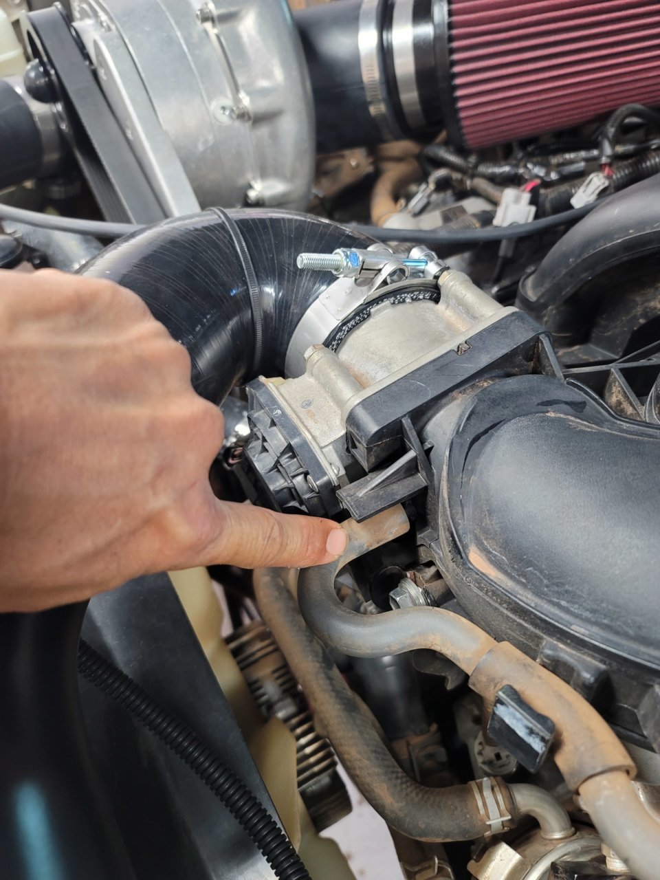

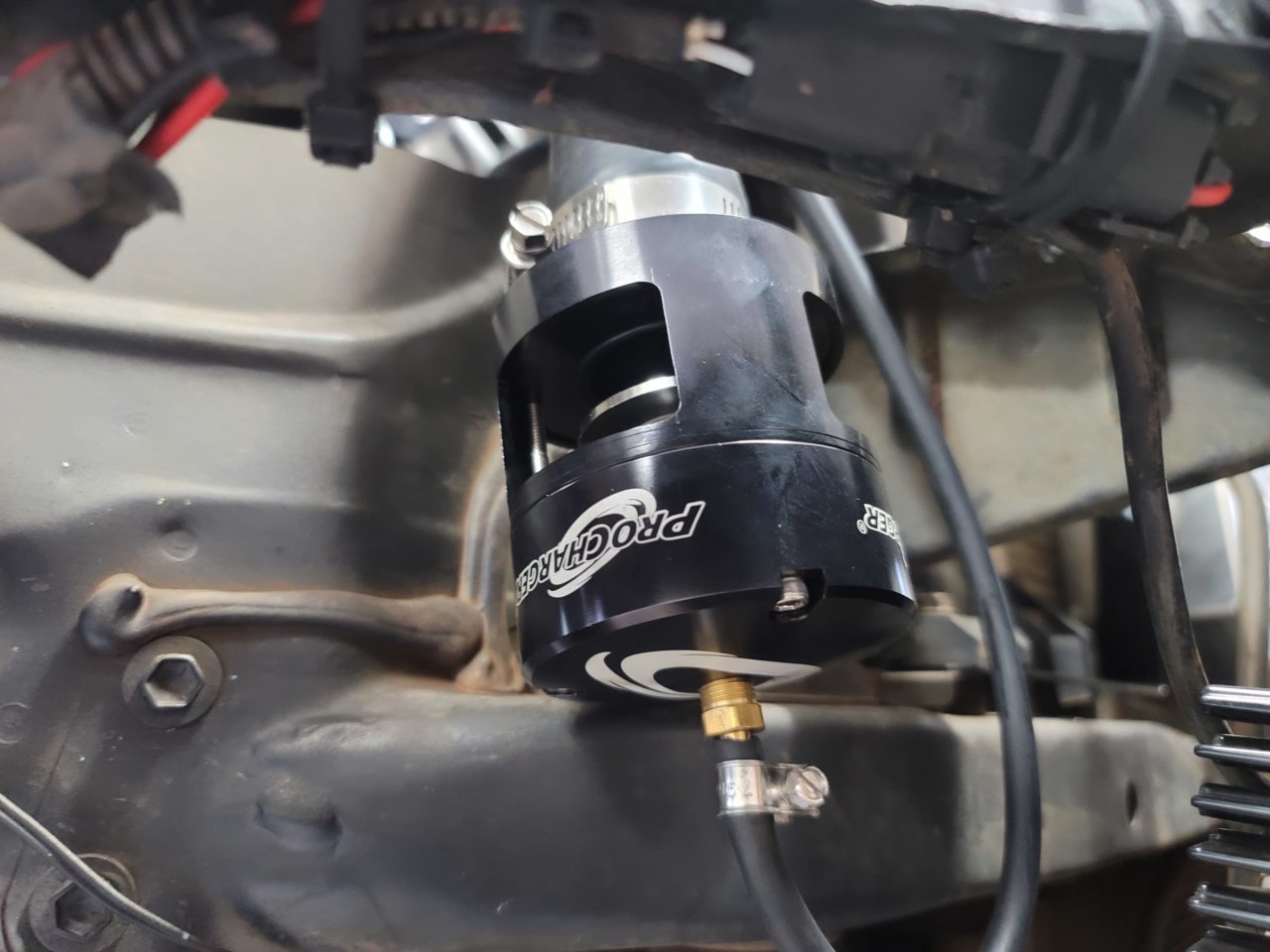

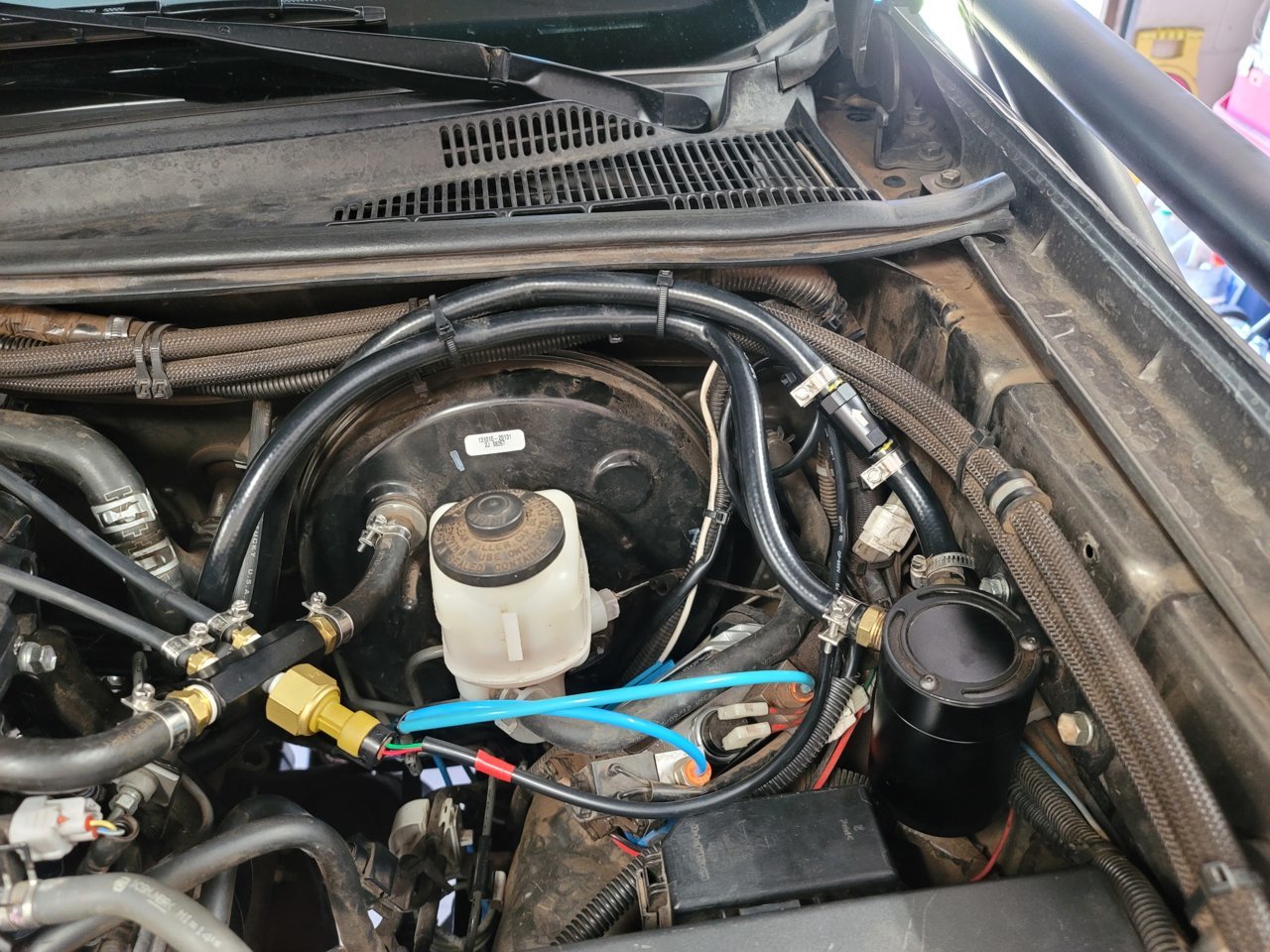

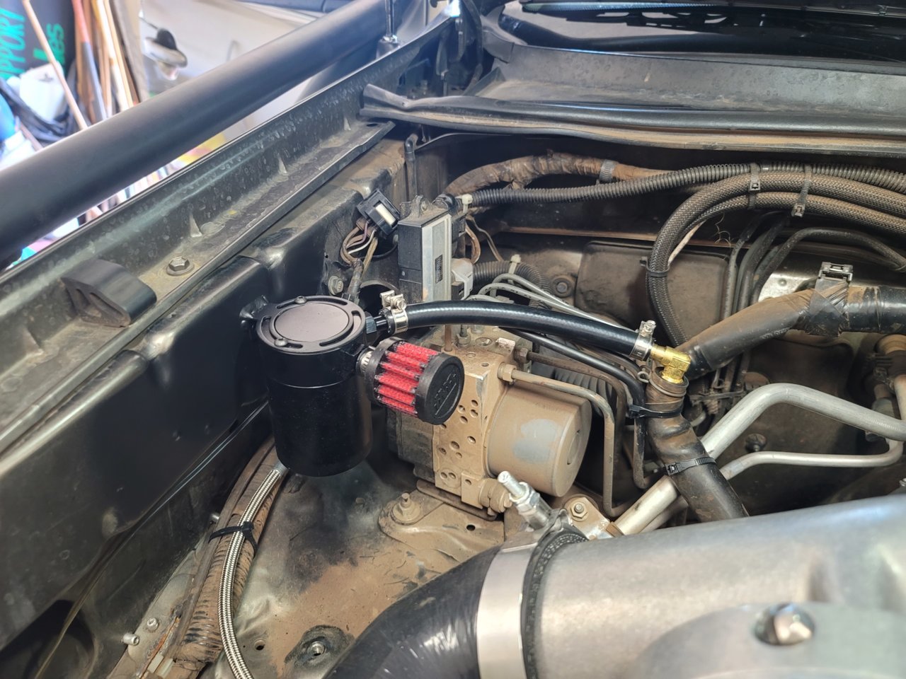

    The last few days have been long, but I got the ProCharger installed along with some oil catch cans. Big shout out to @JustDSM ,who took so much of his time to make sure my truck's tune was dialed. I also installed this bypass valve instead of the "butterfly" bypass valve they include with the kit.
    Oh, and the truck runs awesome!
    And don't forget to put a hose clamp on this hose coming off of the TB or it could potentially throw off your fueling and be a boost leak.
