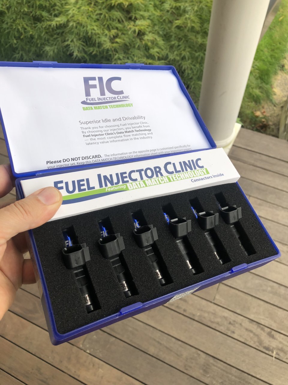

    It’s arrived….
    FICs arrived today as well, such nice packaging
    Just waiting on a Radium shipment and fuel rail fittings.C7907A6F-C8B9-4216-BCEB-8CBDDE08B76C.jpg

    You doing aftermarket FPR?
  8. Sep 23, 2021 at 8:46 PM
    #528
    Hawk373
    Hawk373 Well-Known Member
    Dec 10, 2013
    #118276
    1,321
    2012 TRD Sport DCLB
    DMZ, ADS, King, JFR, SOS, ECGS, LSK
    Yeah, the Radium direct mount. I picked up one of the billet rails way back. Think I’m going to have to fuss with the fittings a bit to get everything set right.
    I have the AEM340 and an in-line FST filter feeding everything.

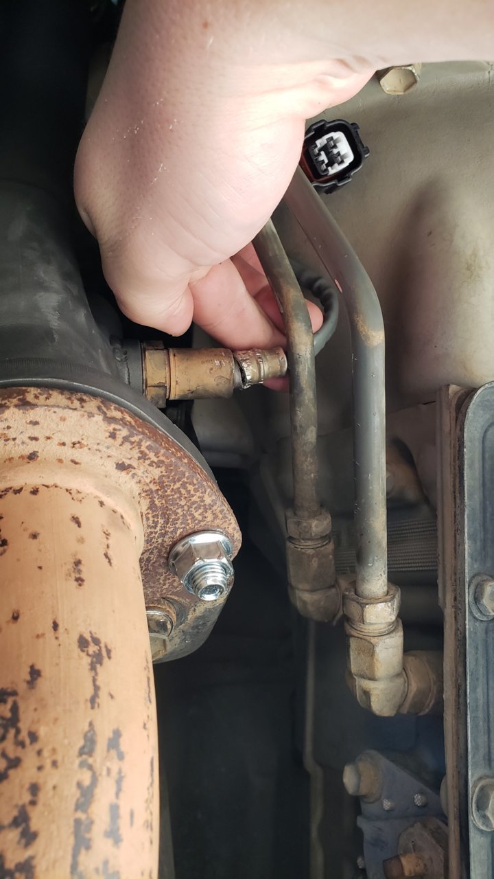

    URD equal length headers and URD fuel pump upgrade kit installed!
    However got an issue, my upstream o2 sensors are being blocked by the transmission coolant lines on the passenger side. I've attached a picture of the old one that I had to cut in half to remove. My buddy who was under the truck for the install I assume just forced them up and the wires got stuck between the lines and the sensor melting them so they needed replaced anyway. If anyone has any advice for how I can fit the new O2 sensor I would be forever thankful lol

    I used a piece of 2x4 and a hammer to gently finesse that line out of the way. It does not have to move a lot.

    2011 Access Cab 4x4
    Mine just sort of goes between the two transmission cooler lines. I cant remember if it lined up that way or if i had to finese them a bit to make it work. But now that sensor just goes in and out between the two lines

    Add a new bung in a better location. Although, that is the lengthiest of the options.
