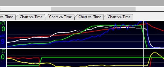

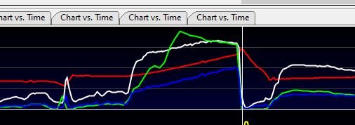

    Interesting observation..
    The ProCharger kit's come with the MAF in a location that puts very turbulent airflow across the MAF.
    *Blue plot is the MAF signal*
    Standard ProCharger kit:
    Standard ProCharger kit w/ custom Airflow straightener pre-MAF:
    Biscuits, Hawk373, mav and 1 other person like this.

    They also taper the pipe from 3" to 2.5" for the FMIC, then back up to 3" before the maf tube. One could assume that some efficiency is lost over those 3 pressure conversions, but also definitely contributing to the turbulent air the the MAF is seeing.
    Performance MRP sells maf housings with and without straighteners, I can't really think of any good reason you wouldn't want one in there. https://performancemrp.com/

    Very interesting, and much easier to tune around, post straightener.
    Biscuits and Hawk373 like this.
