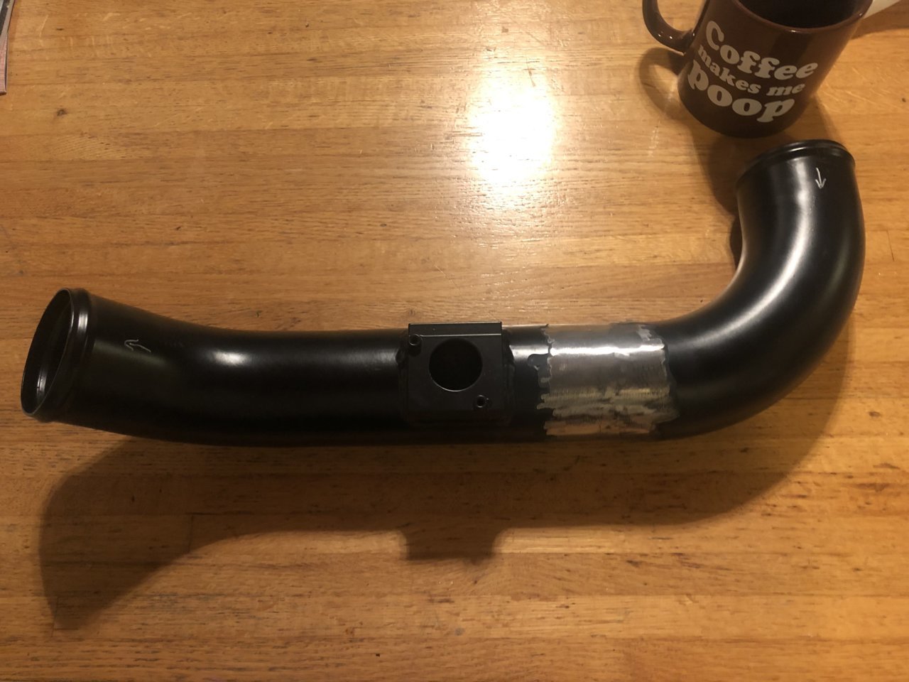

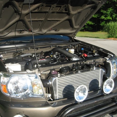

    These are from his online store. I should have mine in hand tomorrow.
    0C51BA8A-77EC-4C91-ABD4-5F1F7B16FCA9.jpg 849D8DA6-3325-45B0-965E-8049FC2215CB.jpg

    Do you think you’ll be able to wiggle the straitener up past the bends or cutting the MAF tube for easy access?

    I'd probably cut it and re-weld(steel pipe), but you could just use a silicone connector to patch it up too.

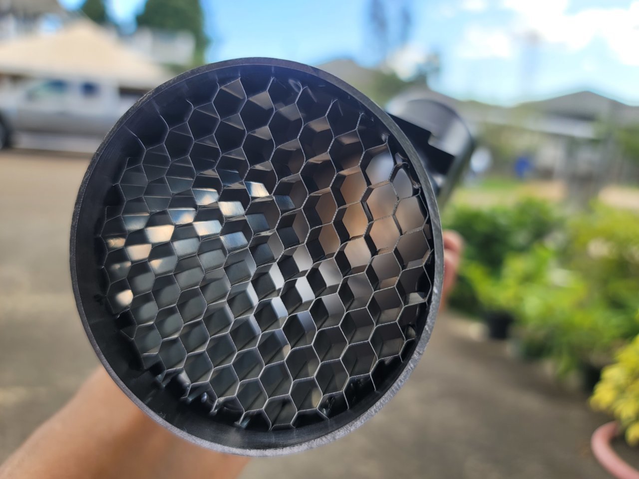

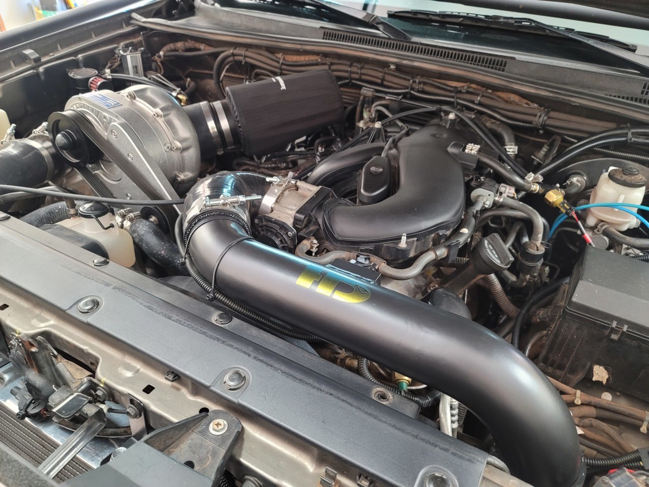

    I cut mine open and epoxied the airflow straightener about 3" in front of the maf and welded back together.

  8. Nov 19, 2021 at 10:33 PM
    #568
    deeezy
    deeezy Well-Known Member
    Sep 1, 2013
    #111645
    5,253
    Dana
    Hawaii
    2013 4x4 DC, 6 spd, TRD Sport
    King ext travel coilovers, Icon tubular UCA's Rear-King "Tundra" 2.5's, Allpro Expos, TRD cat-back, Hurst/Core short shift kit, etc...

    Did you notice any drivability improvement afterwards? If that curve Justin posted was yours I bet it feels a lot better.

    Totally better in all areas. It most likely was my log. It smoothed everything out from light throttle to wot.

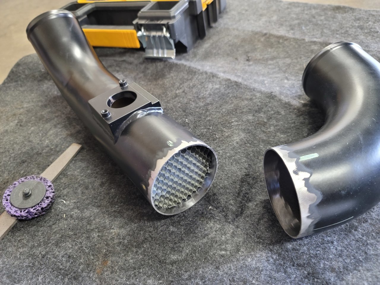

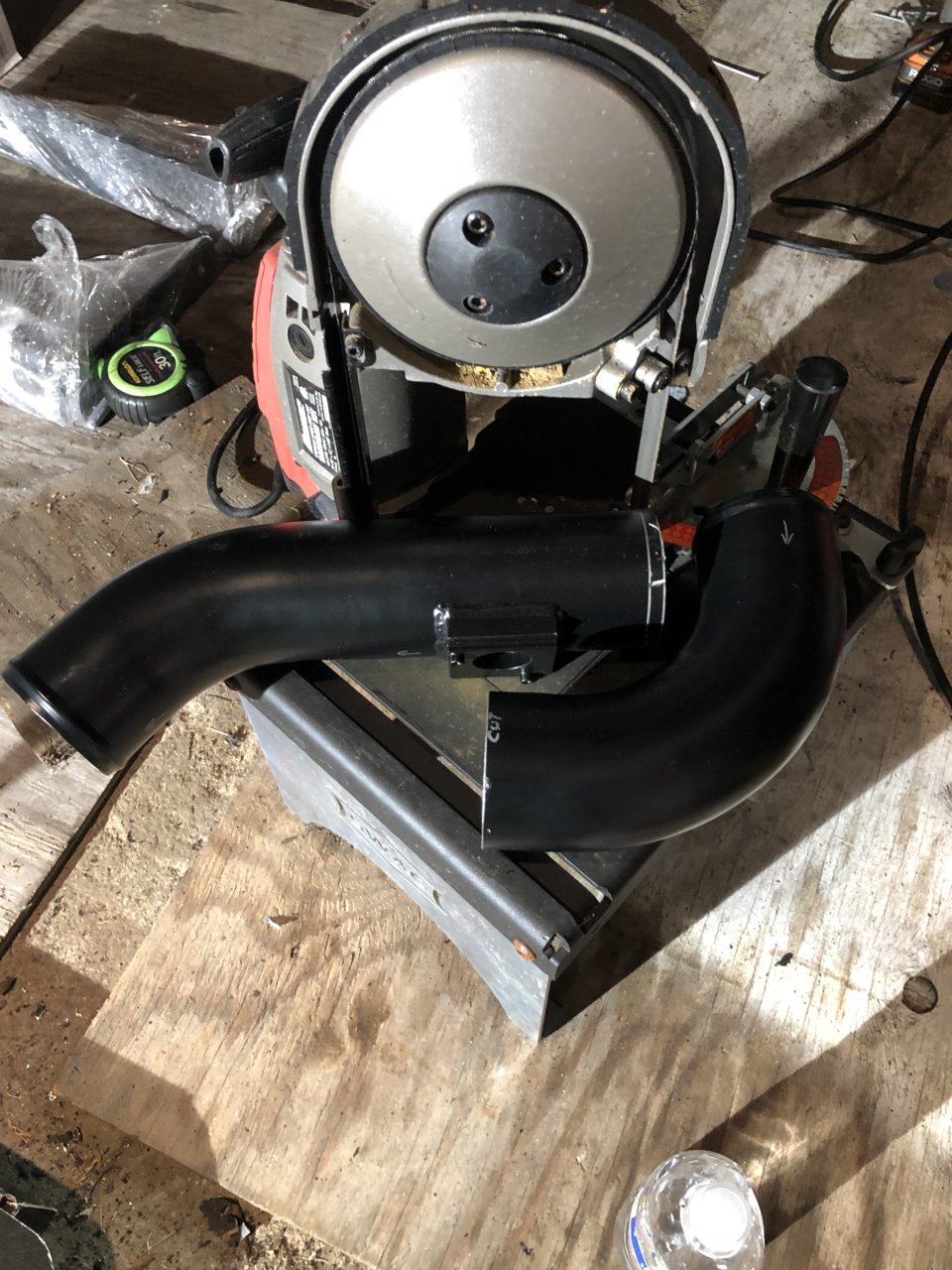

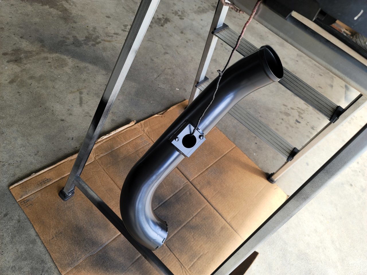

    Successfully copy-catted… just have to set up my infrared heater for paint tomorrow.
    My coating shop is down a few weeks for a fit-out unfortunately, so no powder at available at the moment.

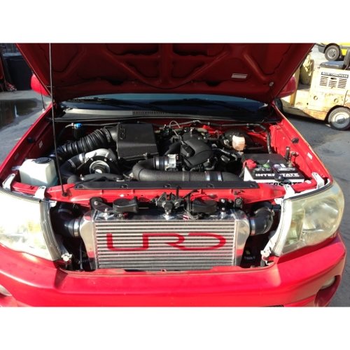

    I also gathered all my plumbing together to retrofit the 3” URD cooler into the system.
    I’ve been holding off for some 1/2” stainless hard fuel line to arrive, but will use the OE lines for now to get moving. 816E706C-B858-4A0B-AEEA-D7B9093B1FA7.jpg D5DFDBCE-D469-4B4E-8787-9CFDCA2A9F33.jpg EC601033-54E7-45DD-A1E7-BB6062C18687.jpg
