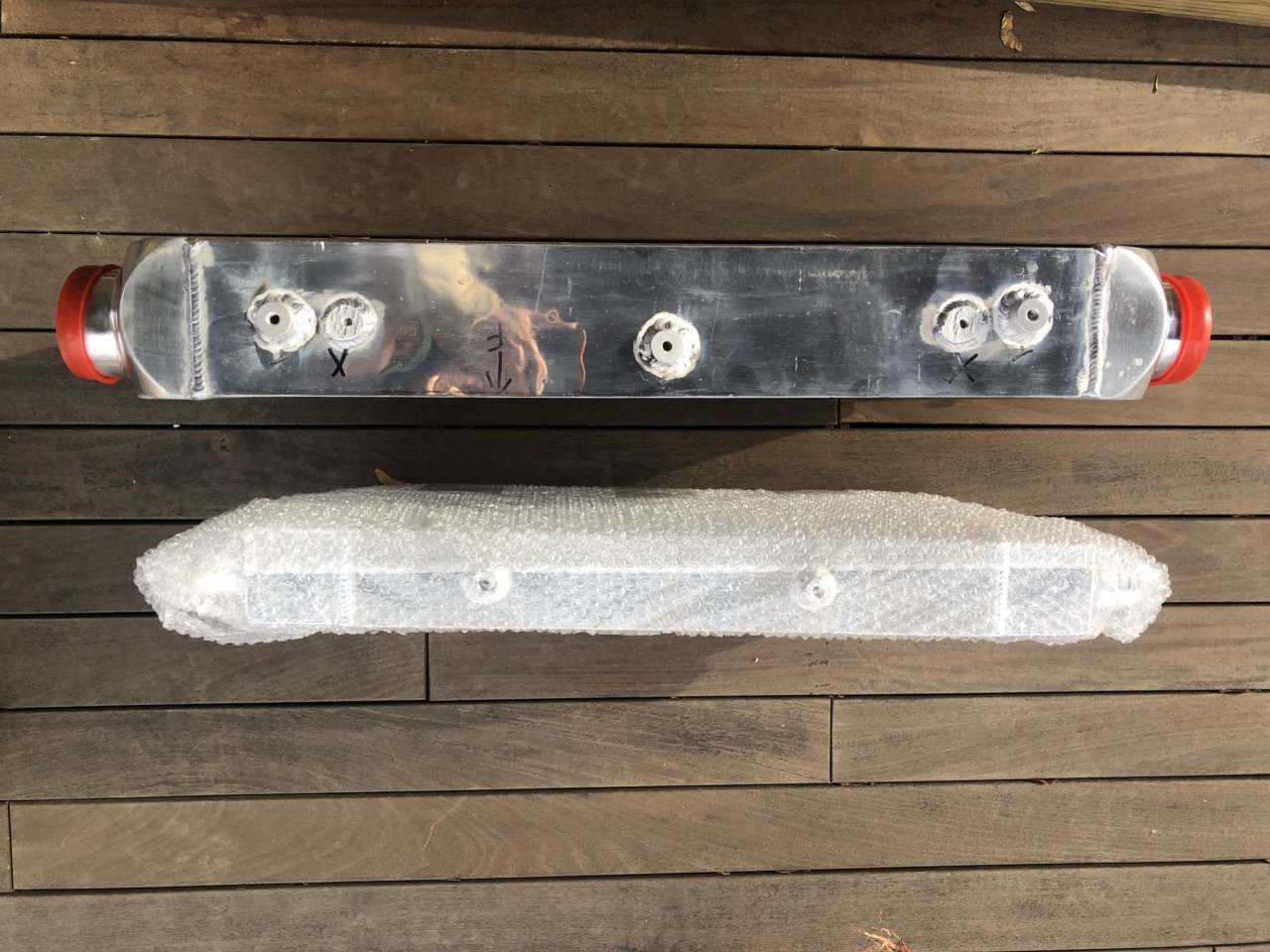

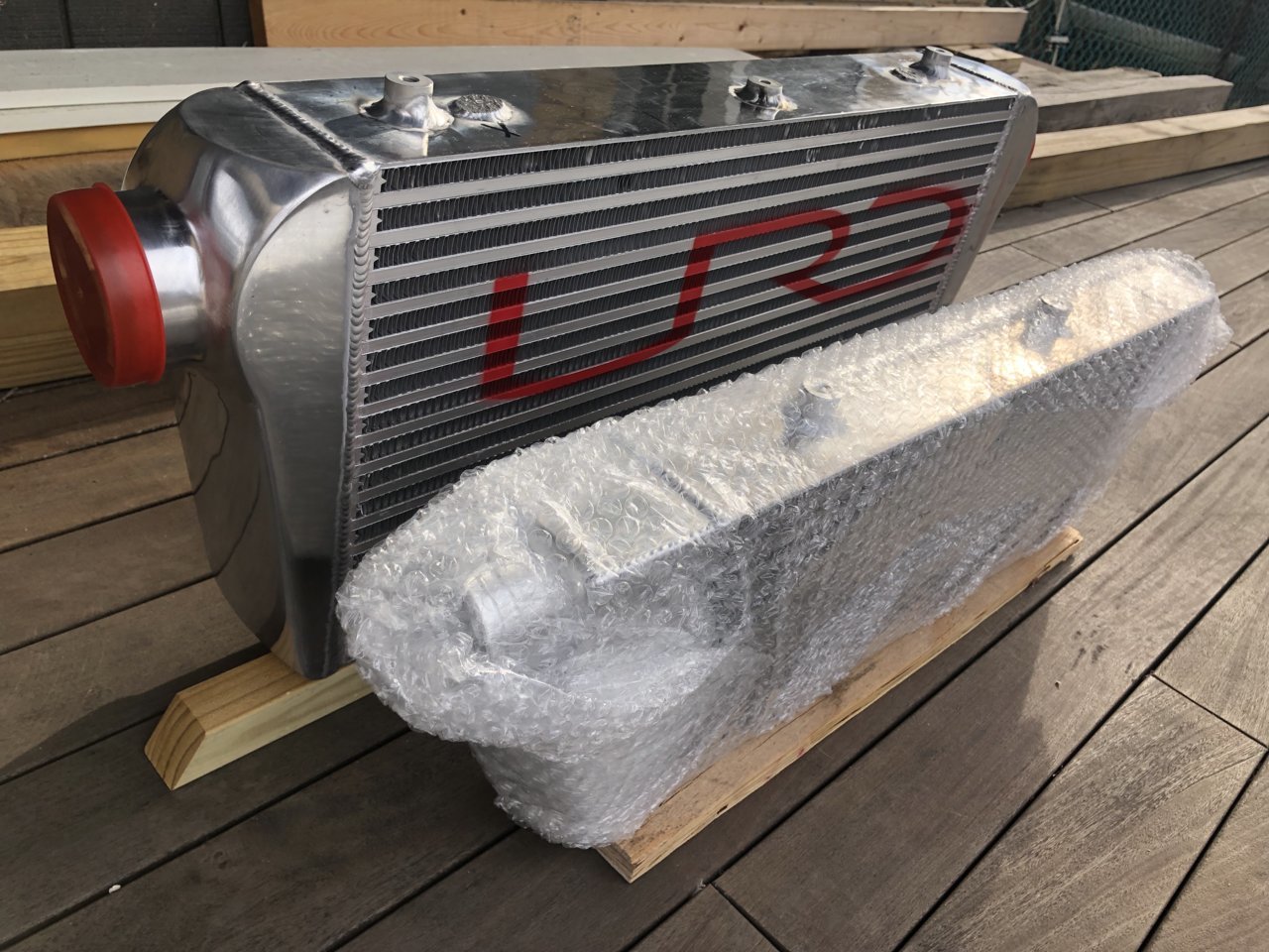

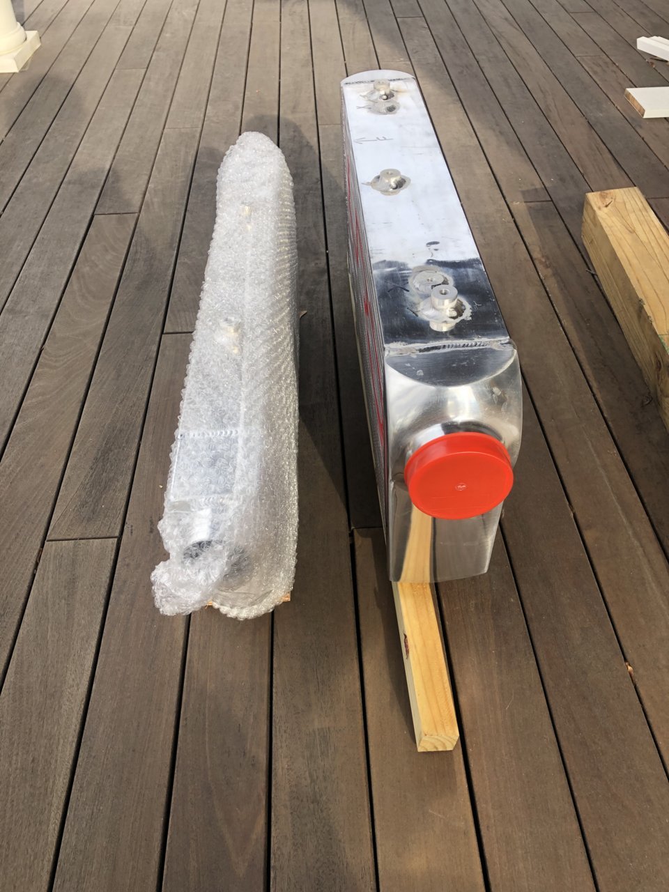

    pretty significant size difference in comparison. The fin designs are significantly different between the two as well. The Procharger fins are very thin, tight together and the spaces between bars are shorter. You can clearly see how wide and open the URD fins are.
    I’ve read lots of conflicting arguments between which design is better; even deformities in the fins themselves to slow down and maximize heat transfer to the air.
    The one thing most agree upon are Garrett cores being the best. Maybe one day…
    I’m not sure what URD uses, the cooler itself is repurposed from some other application I’m unaware of.

    Most of those probably coming off the same boat.. I've had a many ebay intercoolers over the years and haven't had a problem with one yet. Spend the $$$ where it matters.. Beer of course! :cheers:
